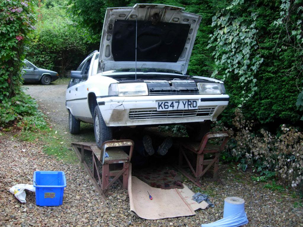

Still feeling a tad, 'ruff', bloody virus just wont let go, however made myself change the MK 2 rad to a Mk 1 on Gloria and bloody glad i did as it was all gunged up inside. Backwashed the system for about 15 mins, refitted the new one and now she is 'purring'.
Needed doing for a while i guess.
Whilst i was doing this, Tim appeared, his missus's BX had developed a slightly serious bleed whilst on the way to the West Country and he, good man had gone after her with his BX to do a swap so that she could continue her journey without any red lights on the dash. Good thing he did cos with the motor up on the ramps, green blood everywhere. It turned out that when the octopus was done about 5 years ago, a return pipe hadnt been pushed home properly and had let go. Managed to get it back ok but not in as fully as he would have liked. Fingers crossed it dosnt pop again.
Mind you, those ramps are a godsend!!

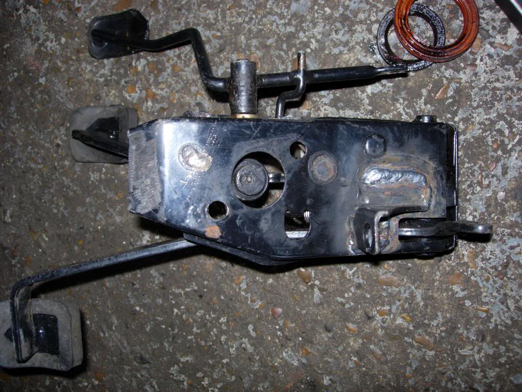

Malcolm was replacing the pedal bracket on the TXD yesterday. These few piccies show where he had reinforced the spare so the problem wont occur again.

One thing I noticed on my white one, was that the way I adjusted the throttle cable meant the pedal wasn't bottoming out on the plastic stub in the carpet. With use, this would bend and break the accelerator side of the pedal box, like it did in my first tgd.

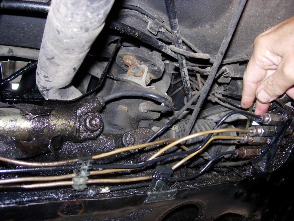

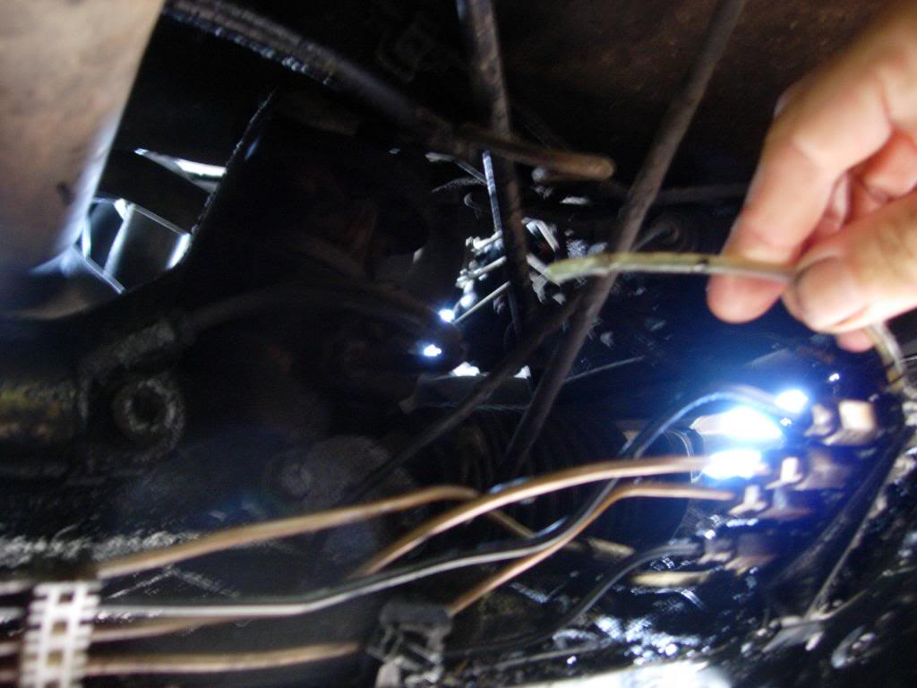

The octopus leak - poxy thing. What happened was that the strut pipes on the White One both sheared off. Cheap rubber.... so I fitted a new pipe set and while doing it, I pulled the rubber pipe off the inner side of the steel connecting pipes. Come off in me hand - it wasn't the correct pipe and was only a loose fit to the octopus. So I replaced it, which was a bugger, and in the process I managed to pull out the plastic section of tube which fits into the top of the puss. With even more struggle I got that little sod back in place.
But... in pulling the octopus forward slightly, the return pipe at the back, which obviously hadn't been pushed home properly when the octopus was fitted, popped out. Next day the car got as far as Sheet before the hydraulic light came on.... as the wife needed the car for the week and gets a bit squirrelly about her beloved dropping green blood everywhere, I drove the Red One down and we did a swap so she could carry on. I decided to RAC the car home as I didn't at that point know what was going on, and drove down to Andy's next day to use the ramps. It's still holding OK. Yet another argument for having the octopus where you can see it!
