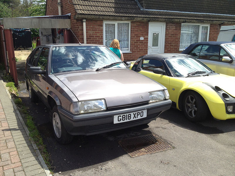

Did you check the link back to my pics on flickr?
http://www.flickr.com/photos/46466362@N ... 118926830/" onclick="window.open(this.href);return false;
IMG_0800 by messerschmitt owner, on Flickr
I swapped the digi clocks over and that one in it worked perfectly (the one in the glovebox was the old knackered one IIRC).
