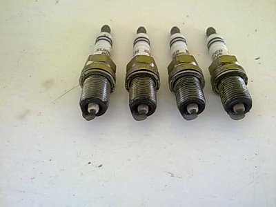

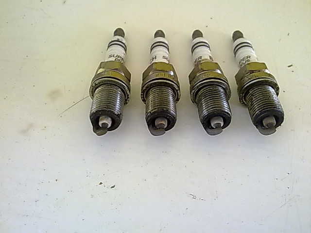

these are the plugs from the gti, as they came out from l-r, 1 and 3 lean? your thoughts.

They look fairly new and a good colour but the pic isn't the best quality.

New plugs only been run for 1000 miles, new cap/arm, coil, leads (boughicord) temp sensor, fuel pump/filter and lines, injectors cleaned, no air leaks, still lean on 1&3 even after richening the mixture back up a few turns post MOT, still a little hesitation in lower rev range. The SAD is working and closes fully once warm, compression is good @ 175. 174, 175. 177, timing is set and vac/ad is working, but still this prob persists, tho not as bad as it was, does anyone know the standard approx factory setting for the air/mixture screw on the airflow meter? Mine is currently set @ 7.5 turns out, running about 4.5 on the co's, maybe needs a little richer? But then the idle is unsettled.

I presume that your GTi is earlier Jetronic rather than Motronic as you mention new cap/arm & coil?rutter123 wrote:these are the plugs from the gti, as they came out from l-r, 1 and 3 lean? your thoughts.
I wonder if you have a sluggish ignition amplifier that is giving a deformed pulse every second output causing a slower burn as a result?
It also could be dirty injectors causing faulty fuel metering. Try swapping injectors 1 & 2 on the rail and see if the lean/rich effect transfers.

Have had the injectors cleaned, yes is jetronic LE3, thats a good shout with the injectors, will swap 1/2 and 3/4 round, but if there is still running lean then there is a significant prob somewhere, then it gets down the electronics side of things which is way out of my league, ecu hell.Way2go wrote:I presume that your GTi is earlier Jetronic rather than Motronic as you mention new cap/arm & coil?rutter123 wrote:these are the plugs from the gti, as they came out from l-r, 1 and 3 lean? your thoughts.
