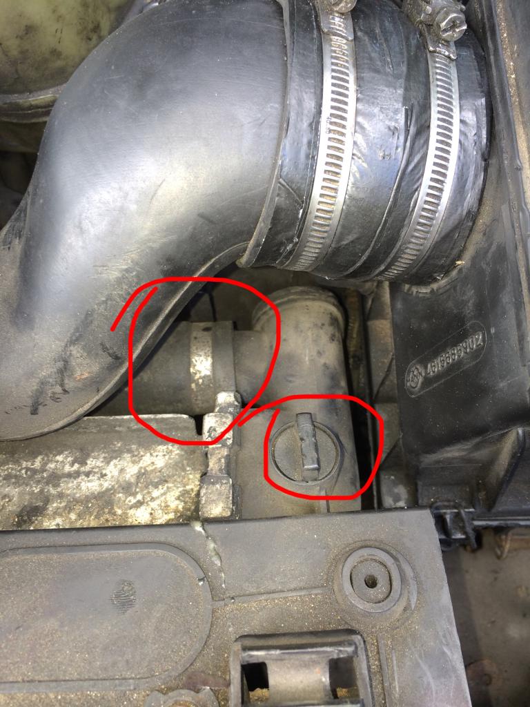

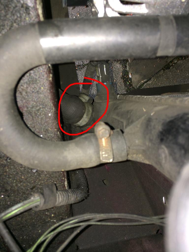

Got some holts speed flush to do the job but I just wanted to check, I undo this bottom hose
And this top hose
And I open that bleed screw when refilling to get the air out right ?
