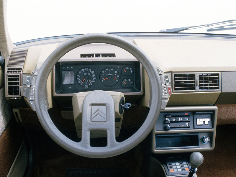

Nope, it should be very light, I would lubricate the carb linkages,
You should have no warning lamps on when its up to temp except the handbrake (if its on)

I meant what are the lights for? One was flashing when it got hot (thermostat opened as rad and hoses hot), out of the 3 warning lamps it was the lamp on the right
Re: BX GT saved!
Sounds like it's overheating.

You get used to that, one is a low water light and the other is a temperature lamp, was the STOP light on?

My camera is broken so excuse me using someone elses pic, but on the top left are the water lights:
water temp water level water temp
Only the one on the right flashes, the one on the left didnt?
