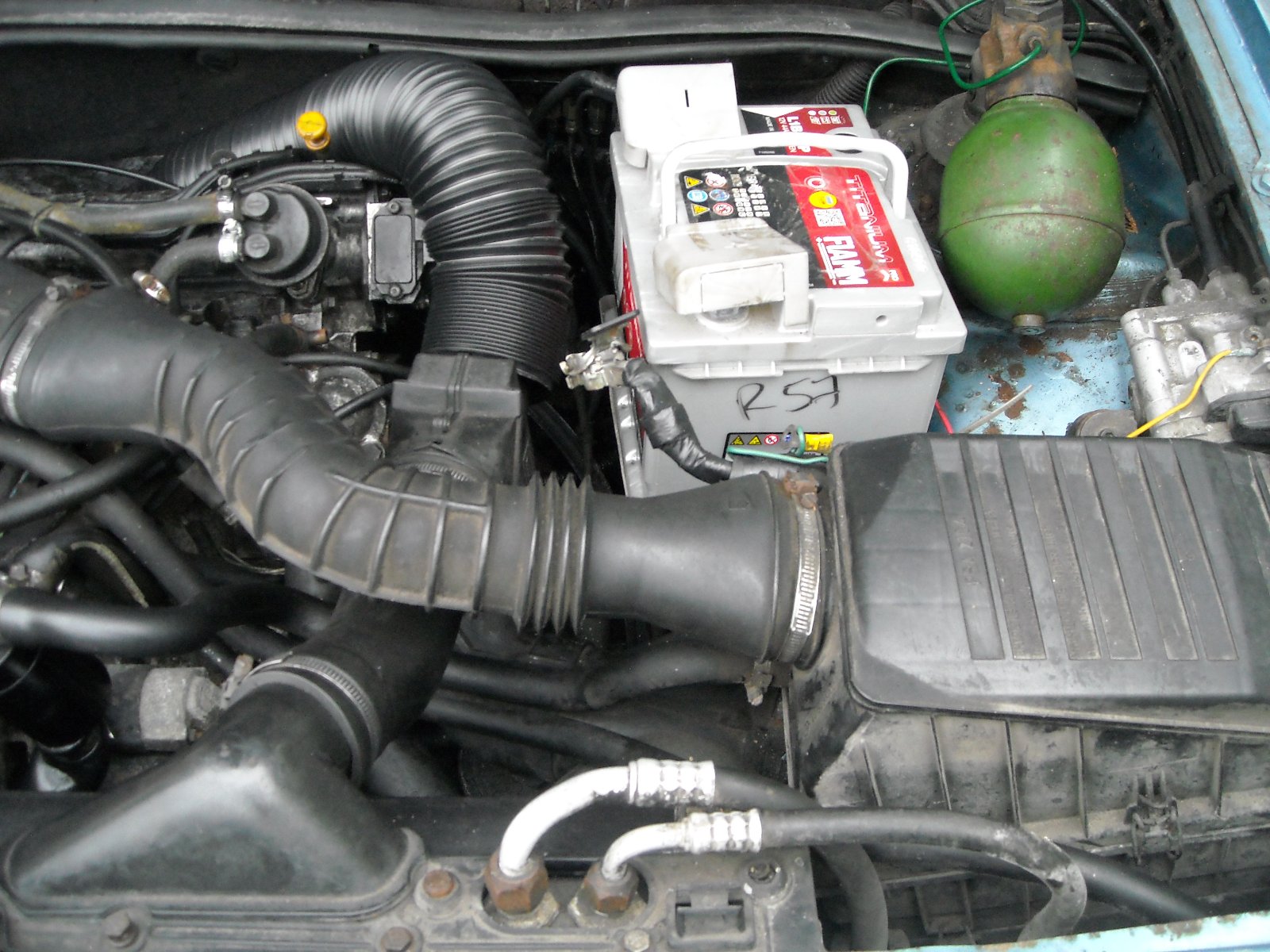

Hi All
Bit of a tight shot, I'm trying to get a wider view, but can anyone tell if this is an 8v or 16v?
Cheers - Justin
Cheers - Justin

Re: Which Engine Is This?
I've had a look on Google for 16v engines and they seem to have a decorative plate at the rear of the bay emblazoned with '16v', which this doesn't have, so I guess this isn't, unless that decoration came later and they don't all have?!!?!?!?!
8v.
That "decoration" as you call it is the camshaft cover on top of the engine.
Well, for starter's that's a carburettor, so not a 16v.
They look completely different. Google image search BX 16v engine, and then BX 19TRS engine. You'll soon see the (numerous) differences.
That looks like a 1.9 8v carb engine to me, but it could be a 1.6.
Kitch,
its a 1600', the intake is a bit different to 1900's.
Chillmax, there was only one 16V engine in the BX, you over there in UK call them "valver", its a "tuned" 1900', and equiped with Katalysator or none (these without run much better). Like OH COCK Jay said, the sparkplugs cover is coming with the "16V" signature, it was a thing then, back in the 90s.
The Valvers are the most powerful BX, pretty sporty and rare (at least here in Germany). If you don't mind to have a highpowermachine, any 1900' will be fine for you. I don't see any plus from the 1600's towards the lightweight 1400's but they are very common, too. (nearly same poweroutput since they are heavier but the smaller ones are more fuel efficent plus very easy to maintain). Best you can do, i think, is a manual or automatic late 1900' (GT/GTi), they are powerful and fits very well into a BX. Don't underestimate the 1400's for the less extra BX's, a 75bhp engine can handle 900kgs very well, believe me.
