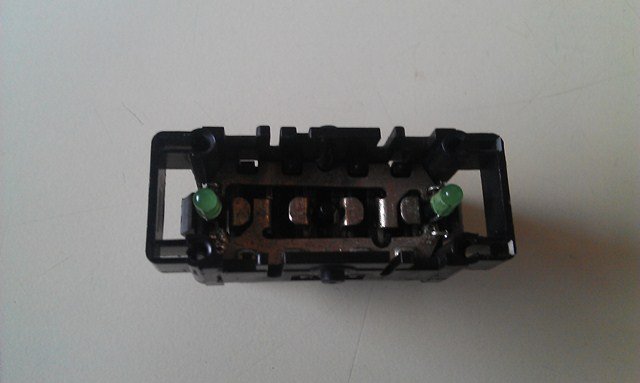

If you use XM buttons, they have the green illumination in them. The BX needs bulbs or LEDs putting in.

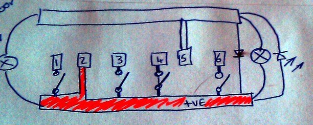

I found these, so maybe I wrote the post about adding lights and just forgot?

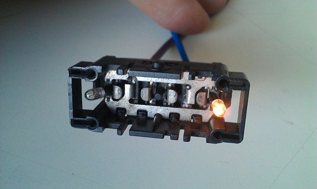

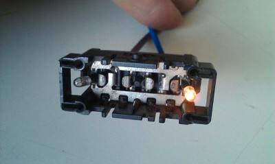

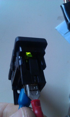

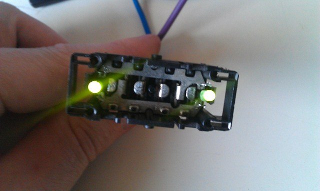

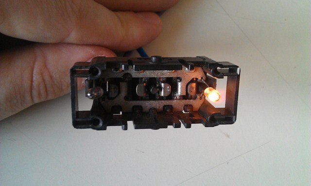

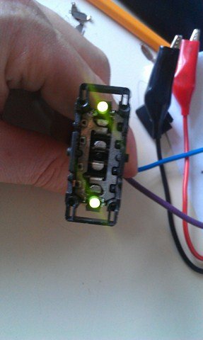

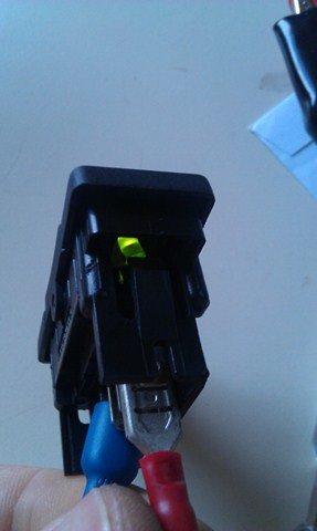

Yeah, the illumination isn't a problem as I've actually done it in my drivers side one touch window and my two "normal" passenger side switches, only I've used yellow and red LEDs just so they're different.
I got a bag of different coloured LEDs and resistors at the time. I might have even found your post at the time which might have given me the idea (it was around 2013 that I put the lights in them).
I was actually wondering if there were any later cars with compatible switches (as in the same size with 4 buttons & leds already in them) that would fit the BX, otherwise I'm just back to square one of needing 2 original switches.
I remember that the one touch switch doesn't have 1 needed wire (I think it was a live) for the lights, so it needs a separate circuit behind the switch itself with the needed wire provided from elsewhere (usually the other switch).
As for the rewiring, it'll need 2. The existing wiring on the car has only 2 wires that go between the doors, but in order for the switch on the drivers side to work, you need 5 wires in total, although 1 is a negative (I think) so it's common across the car, so you only need 2 more to make the 4 wires in total. They don't need to be as thick as the existing ones are as they just work the control box and don't take the full load of the window motor.
Unless you wire it as Jaba suggested, then you can get away with no extra wires, but at the compromise that one switch will only do 2 functions and not all 4.
