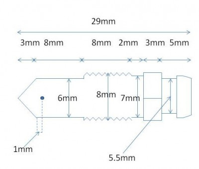

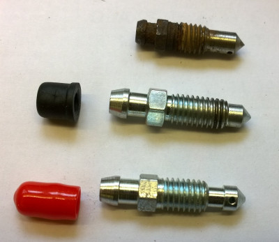

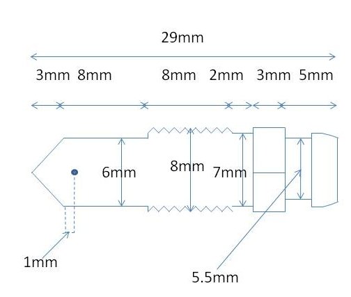

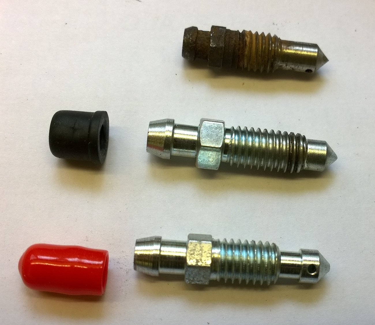

Missed your query as been busy sorting out my BX’s rear hubs. Anyway, the work required me to get a new rear calliper bleed nipple and I thought there may be some interest to see the differences between what I believe is standard, what Autofren have in their caliper kit (D42674C) and the nearest size I found from Bigg Red on eBay (item no. 312519357026).
The original is 29mm long (see my drawing) but the others are 35mm.
The original minimises the thread length presumably to minimise the risk of it seizing in the caliper. But the proper solution is to ditch the zinc plated steel and replace with A4 Stainless Steel or Titanium! Anyone know where you can get some?
