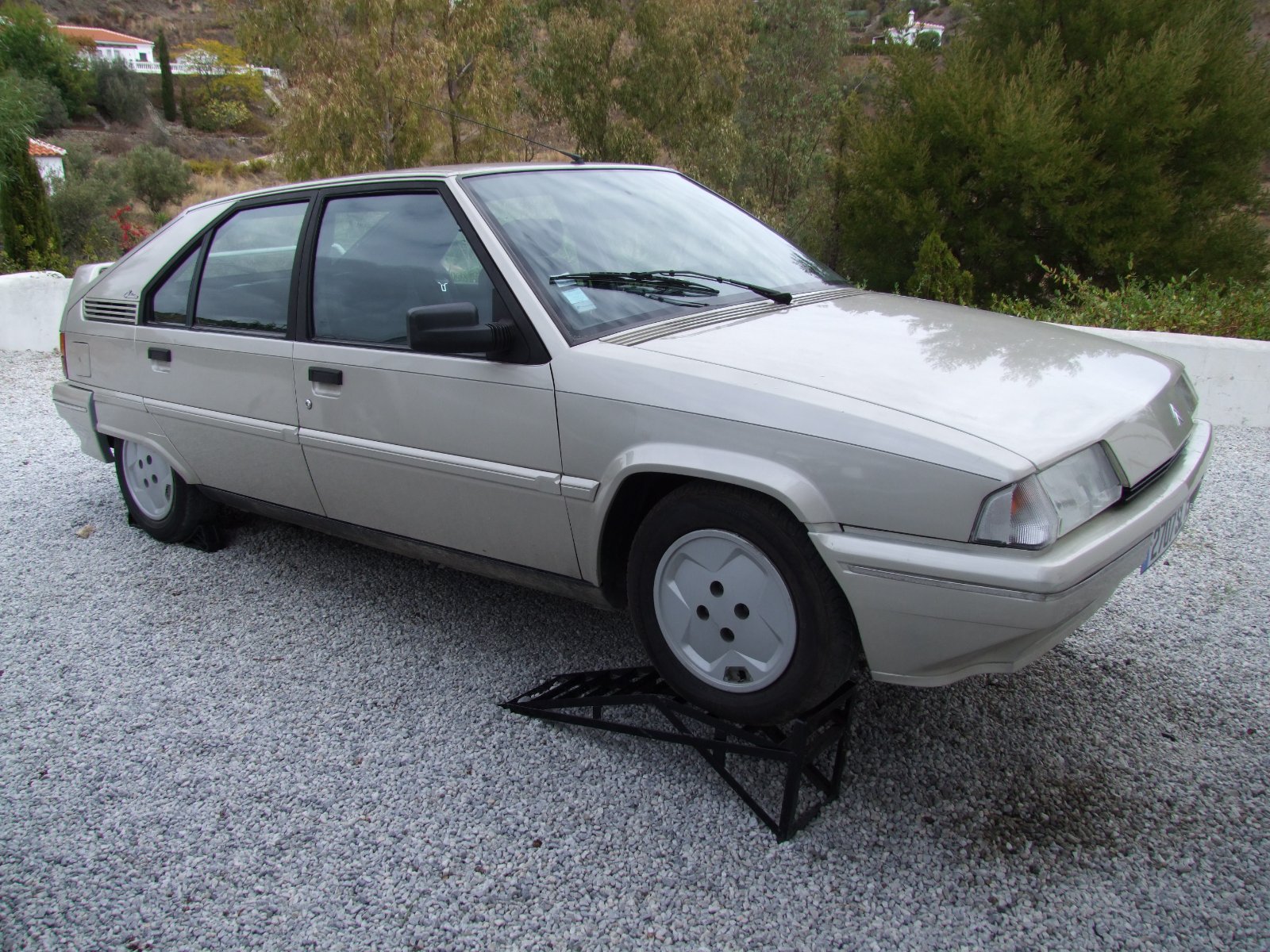

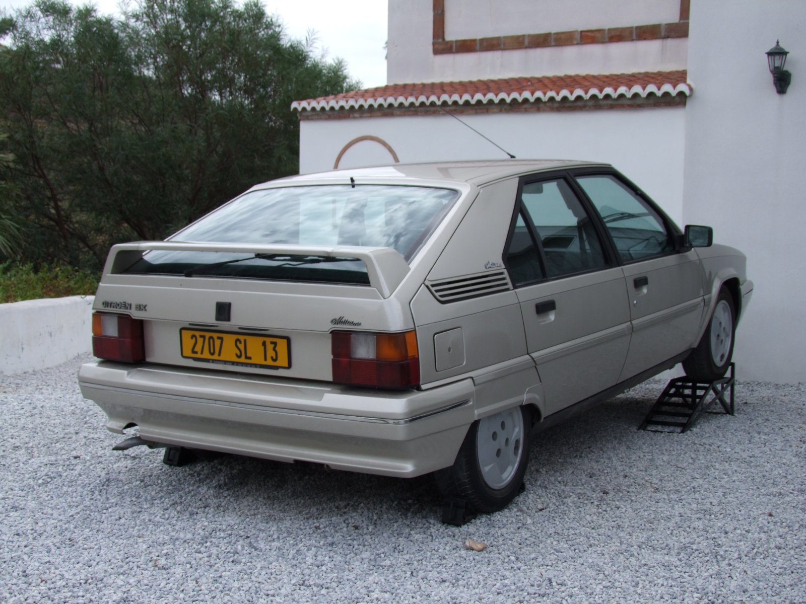

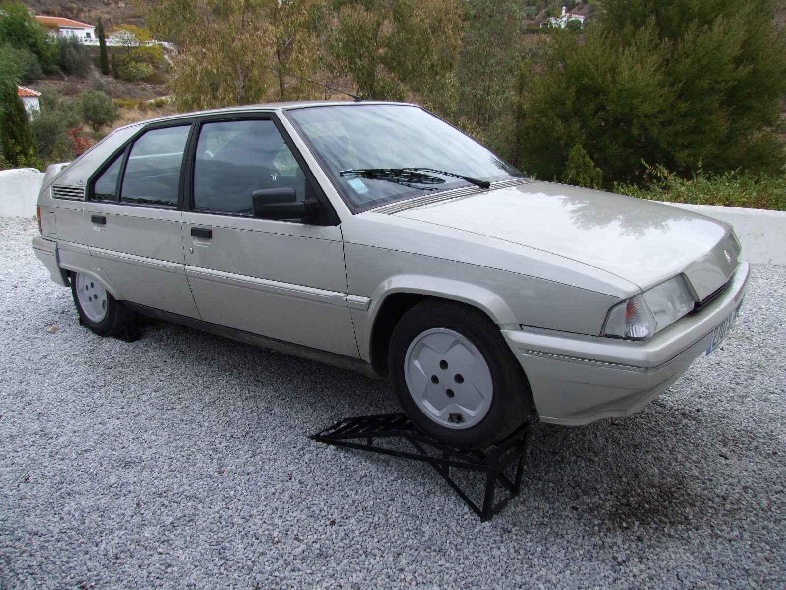

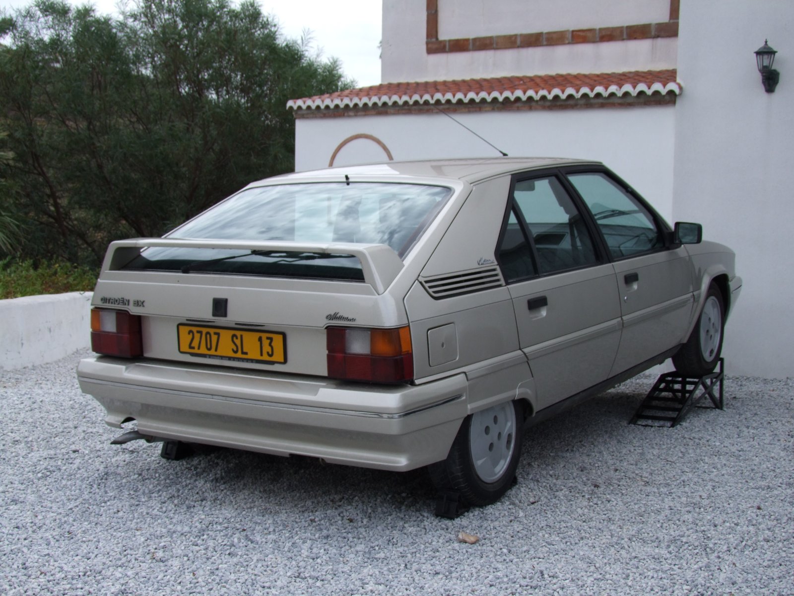

? The new baby
The oil change is about to be done, along with cambelt, coolant, etc etc, so will try that.
Re: Dipstick length - 1.9D
Wow that's a real beauty.
white exec
Posts: 681
Location: Sayalonga, Malaga
My Cars: 1992 BX19D Millesime
- LHD, NA, AC, RP_5800
1996 XM 2.5TD Exclusive
x 73
Post by white exec »
I'm rather pleased with it too!
Just finished sorting a few things out...
- spheres now fitted with Valprex, and regassed
Acc was ruptured, so replaced (ex-XM Hydractive centre sphere, set to 62bar).
Corner spheres just about had 10bar, so regassed. All genuine Citroen, and the correct ones! Time will tell...
- relays and fuses added for main and dipped beam, to reduce load on the lighting switch, and uprated wiring to the H4's.
- glow-plugs and GP relay checked out and contacts cleaned
Only 25A being taken by all four GPs, so maybe a dud or two.
- new cambelt and aux belt
Fully expected those on it to be well used (at 106k mi), but was surprised to find a recent-looking aux belt, and delving deeper, obviously newish water pump, jockeys and tensioner, all ContiTech. So just renewed the belts, and left the rest.
- gear oil changed for correct stuff; what was in there was clean enough, but very 75W-90 looking.
- new coolant and a thorough (temporary header-bottle) bleed
- new engine oil
Book says 5L for a filter change, so that's what it got. Resassuringly comes up to the H mark when the remains of the dipstick is put in to the assumed original position. Good tip, that!!
Sod of a job getting to the 8mm pegging hole for the flywheel. That nasty plastic fuel filter does no favours for access to that end of the engine, and is chokker with flexy conduits running underneath it. The hole took a bit of finding, and then got pegged with a 7mm short rod firmly attached to the end of a bendy-magnetic retriever.
Some minor bits still to sort:
- a pair of decent H4's to replace the French yellows, and some rear dust covers for the headlights
- handbrake lever needs looking at - not reliably putting out the brake light
- screenwash sprinkler in serious water-saving mode
- relay to be added for the starter solenoid, to preserve the IGN sw
- relamping of the dash - several dark spots
- and the dead tacho and dipstick handle, of course.
Needs to get matriculated on to Spanish plates: a ludicrously expensive process, involving coughing up around €1300.
Oh to be doing this in the UK instead!
Some temporary (green) plates - another €100 - allow it to get insured and driven ahead of final plating. Just as well we're not going out to eat as much as usual these days! :roll:
