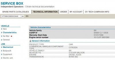

Service Box (characteristics) not much help as it just states "Diesel XUD9"
Is there info anywhere on interpreting the engine number, which is 10 CU3T 0601068 ?

The problem is not with the engine, which carries a serial number that tallies with Service Box vin/details, but with the Spanish registration authorities having read an ambiguously laid out Citroen homologation document for the diesel BX, which suggests (wrongly) that all XB-XC cars were turbo.
The document goes on to detail XB-XC cars as 1905cc and 51kW, which is correct, but they are insisting I provide certification from Citroen Spain to confirm the car is NA. I have messaged Cit Spain, to request some engine data in more detail than S/Box lists.

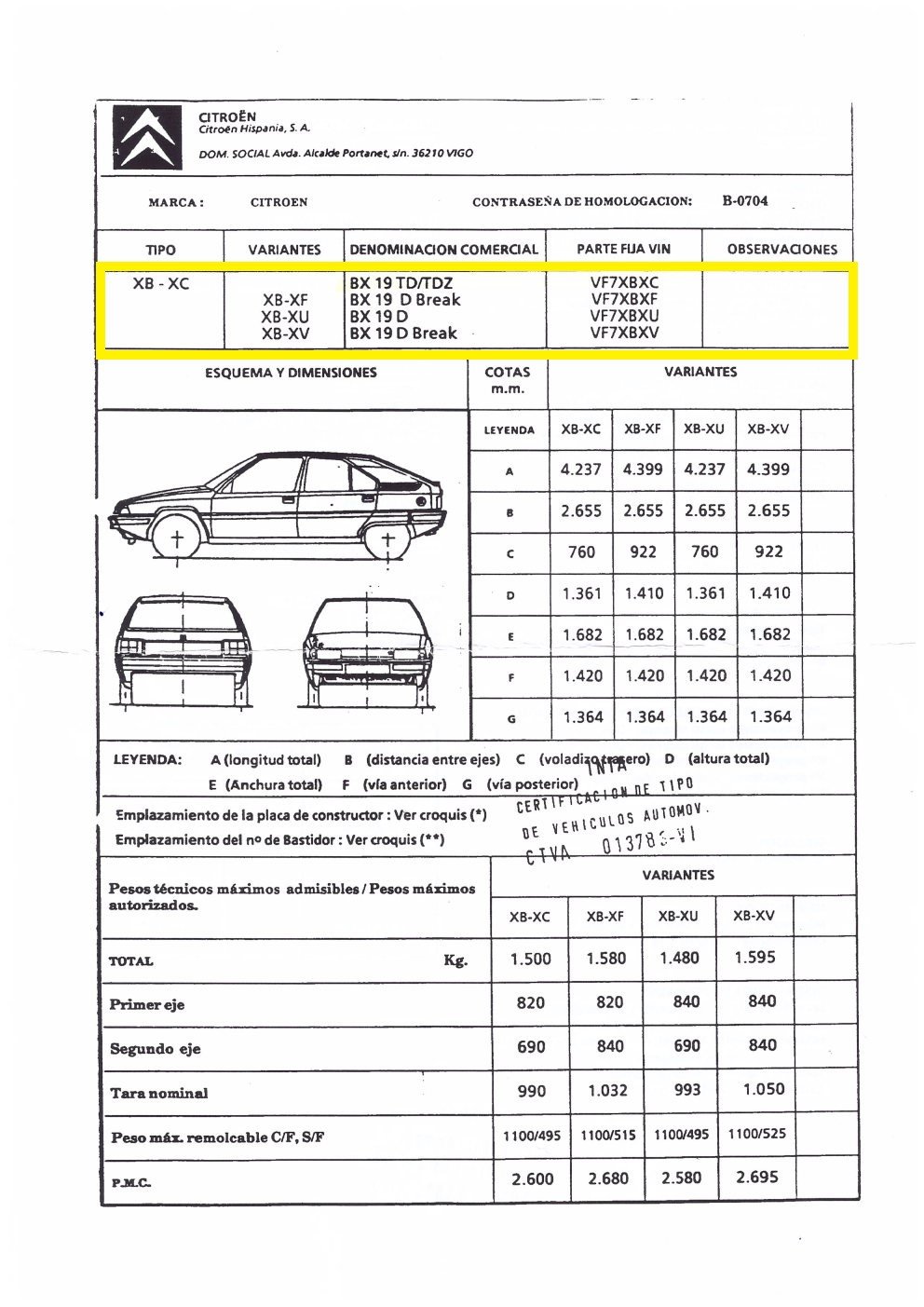

The homologation document obtained by the registration/licensing authorities was this...
. I suspect that the poorly laid out first box (p1, highlighted) was what caused the incorrect 1.9TD entry.
Page 2 makes it clear that the engine is 1905cc 51kW, but that would have meant nothing to the Testers who logged the final paperwork.
- Posts: 6439
- x 94
Re: Engine type?
I can see why that confused them.
Incidentally, the 'XB-XC' thing is a bit confusing (and I didn't explain it well).
XB (immediately after the VF7) means BX. So all BXs are 'VF7XB.......'. Then, it has another two letters, which signify the type of BX, and confusingly, the 1.6 petrol (hatch) is, again, XB. So, it's VF7XBXB.....
Diesel hatches are VF7XBXC...... and so on.
The identifier is repeated again at the end, I assume, for the purposes of shortening the VIN if you were digging out a car in a compound somewhere. My 16TRS is XB9918, so you knows it's a 16 hatchback right away.
