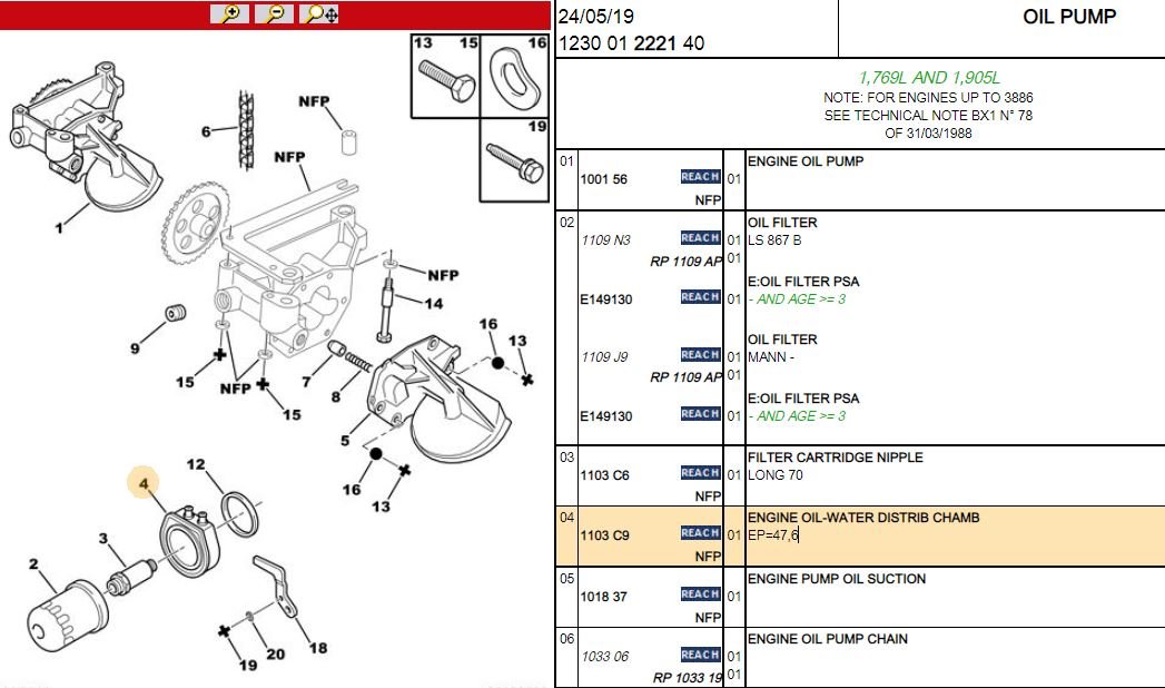

Hi Josh,
Cit Parts listing car as:
RP5518 (= 18Dec1991)
5dr Estate
XUD7TE
BVM5
power steering
depollution
RHD
rear electric windows
air con
Oil cooler/heat exchanger is pt no 1103C9, now NFP from Citroen...
? Click to enlarge
Its height listed as 47.6mm, and will have the central tubular bolt to match.
Possible to fit other sizes, if you also have the matching bolt (which is M20 thread, both ends).
Found new 1103C9 here:
Autodoc uk, at €158.90
Pieces de Rechange Classic (PSA's Heritage site), at €149
The item was also fitted to other vehicles with the same/similar engine:
BX XUD7TE oil cooler 1103C9.JPG (23.61 KiB) Viewed 11501 times
Also fitted to Peugeot 405 II (with similar engines).

The larger engines just got thicker coolers. So long as tubular bolt and cooler match, it will be ok.
Worth replacing the circular seal behind the cooler (#12 above) - mine leaked annoyingly. Still available from Citroen, and not the same (on BX) as the ring on the oil filters, unfortunately.
The steel coolers seem less prone to internal corrosion/perforation than the aluminium ones. If yours is aluminium, be scruplulous about good quality coolant all year round. (Internal perforation allows engine oil to be injected into the lower pressure cooling system - obvious if you look into the radiator/header tank, as it floats to the top. A v.nasty clean-out job... :( )
