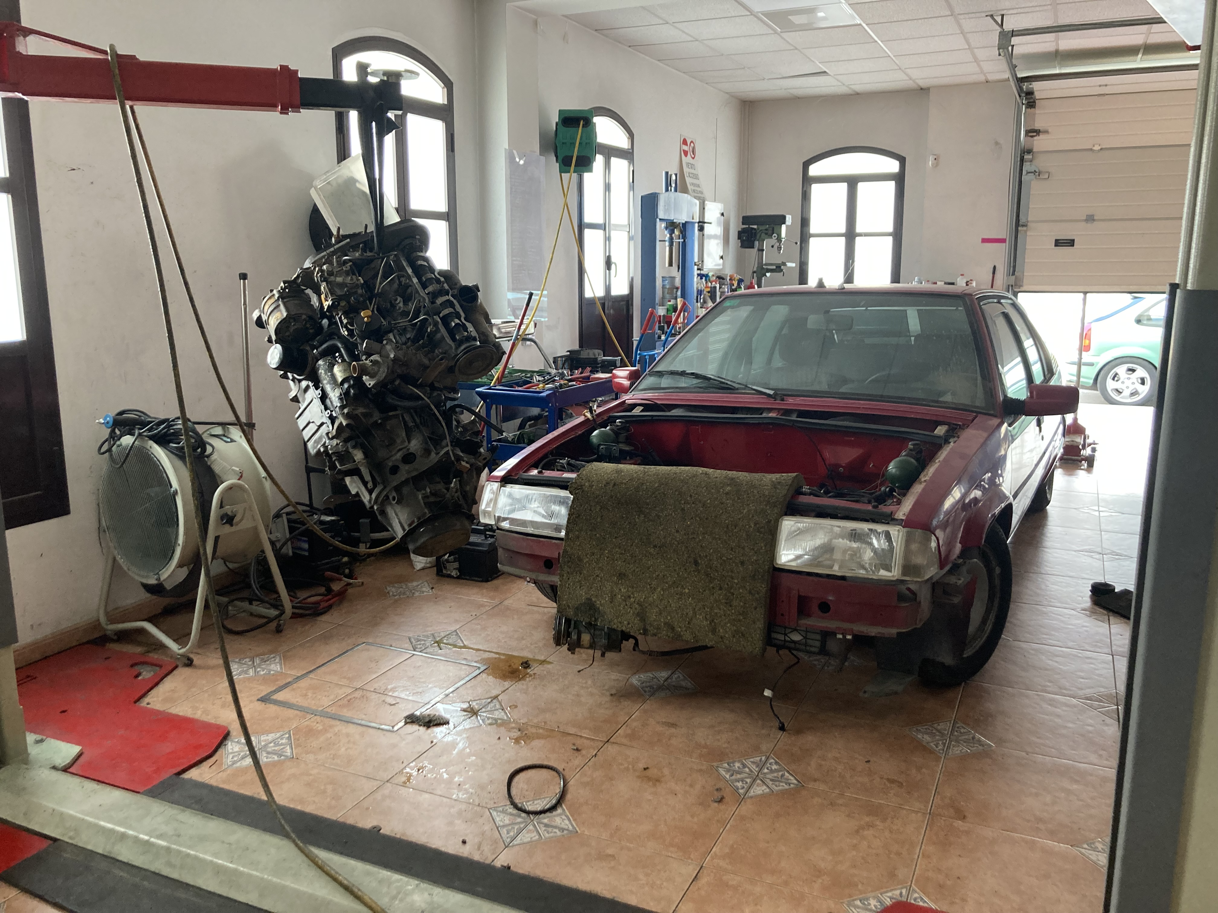

My friend and I have made an engine change. from the 1.7 Atmospheric Diesel to the 1.9 Atmospheric Diesel (it was the engine I found here)

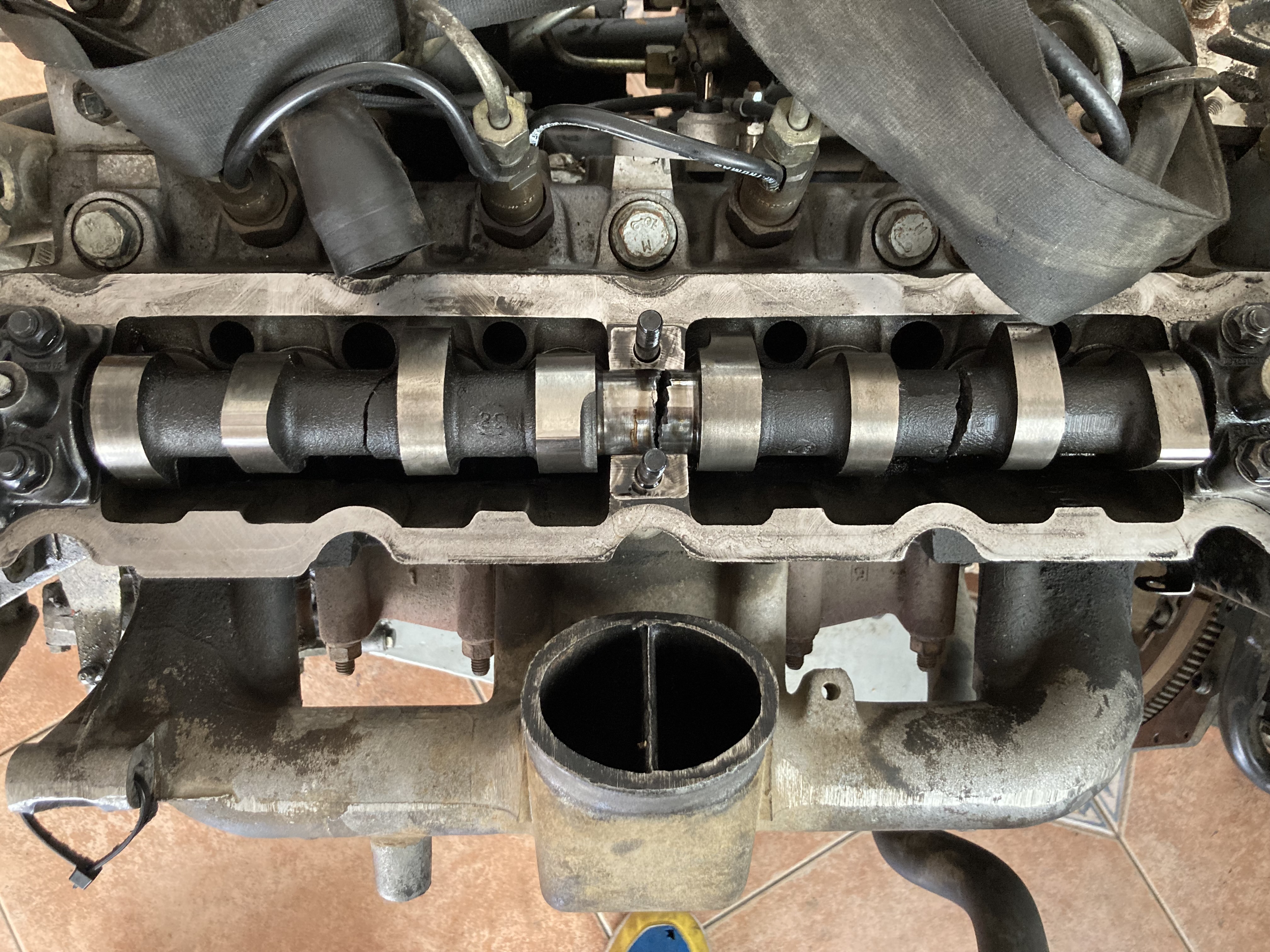

The original engine broke at the camshaft due to poor timing of the timing belt.
oops
engine removal

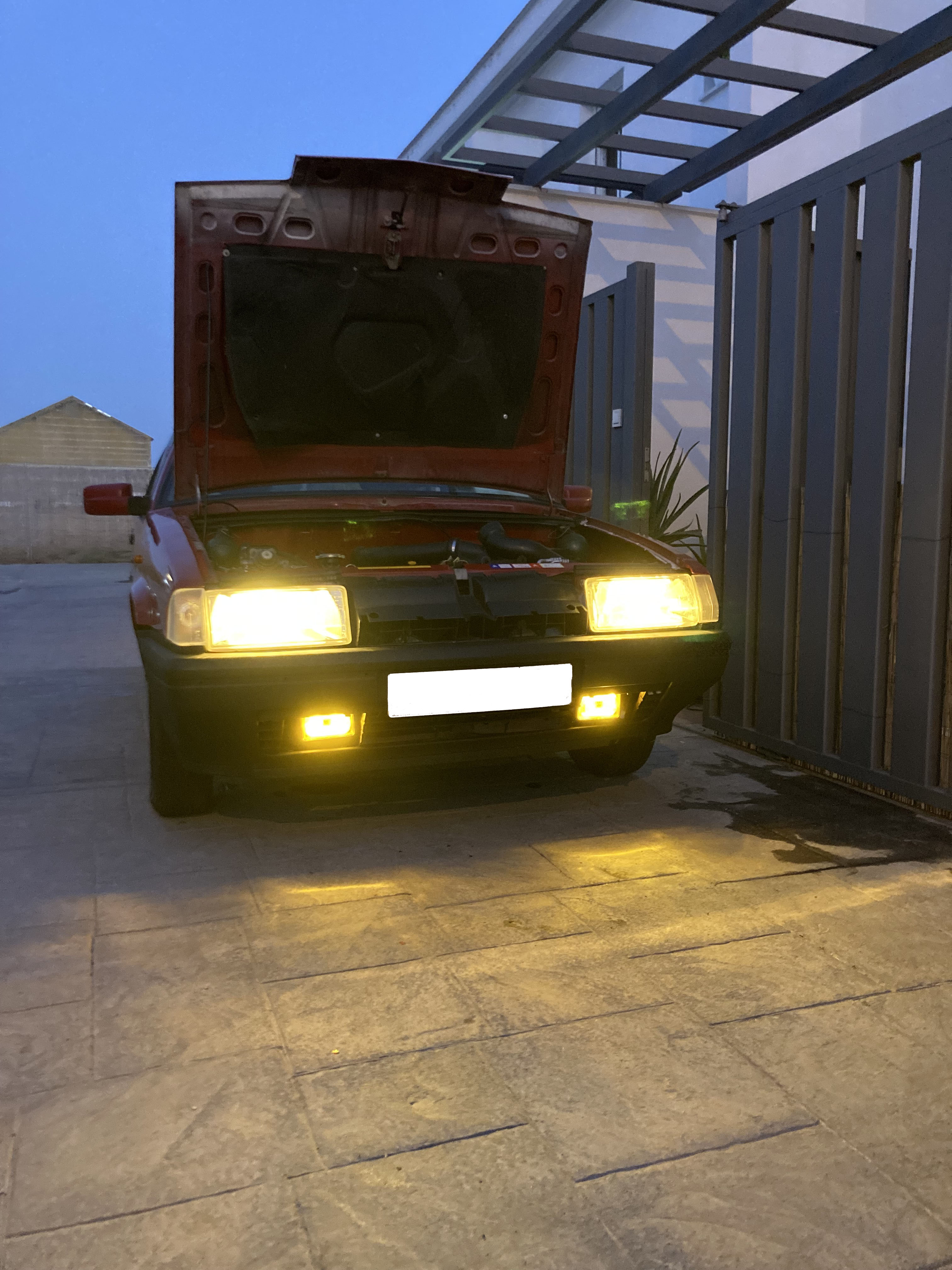

After many hours (all new gaskets, clutch, bearing...) and a **PRECISE** adjustment of the distribution, the car came back to life.
Even the air conditioning works! It was a loose wire...
The previous owner bought the basic diesel version. Then he added details like electric windows, black interior, air conditioning, open door warning and something else.
The car already runs perfectly and is very comfortable to drive. I miss having power steering to park but nothing happens.
