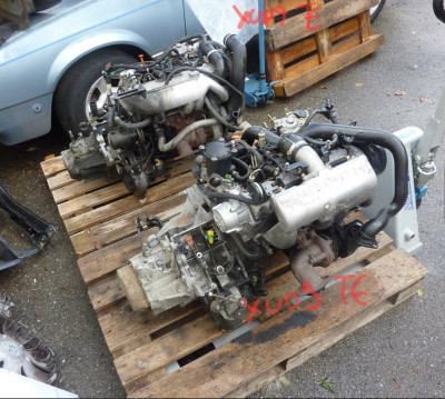

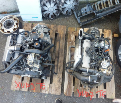

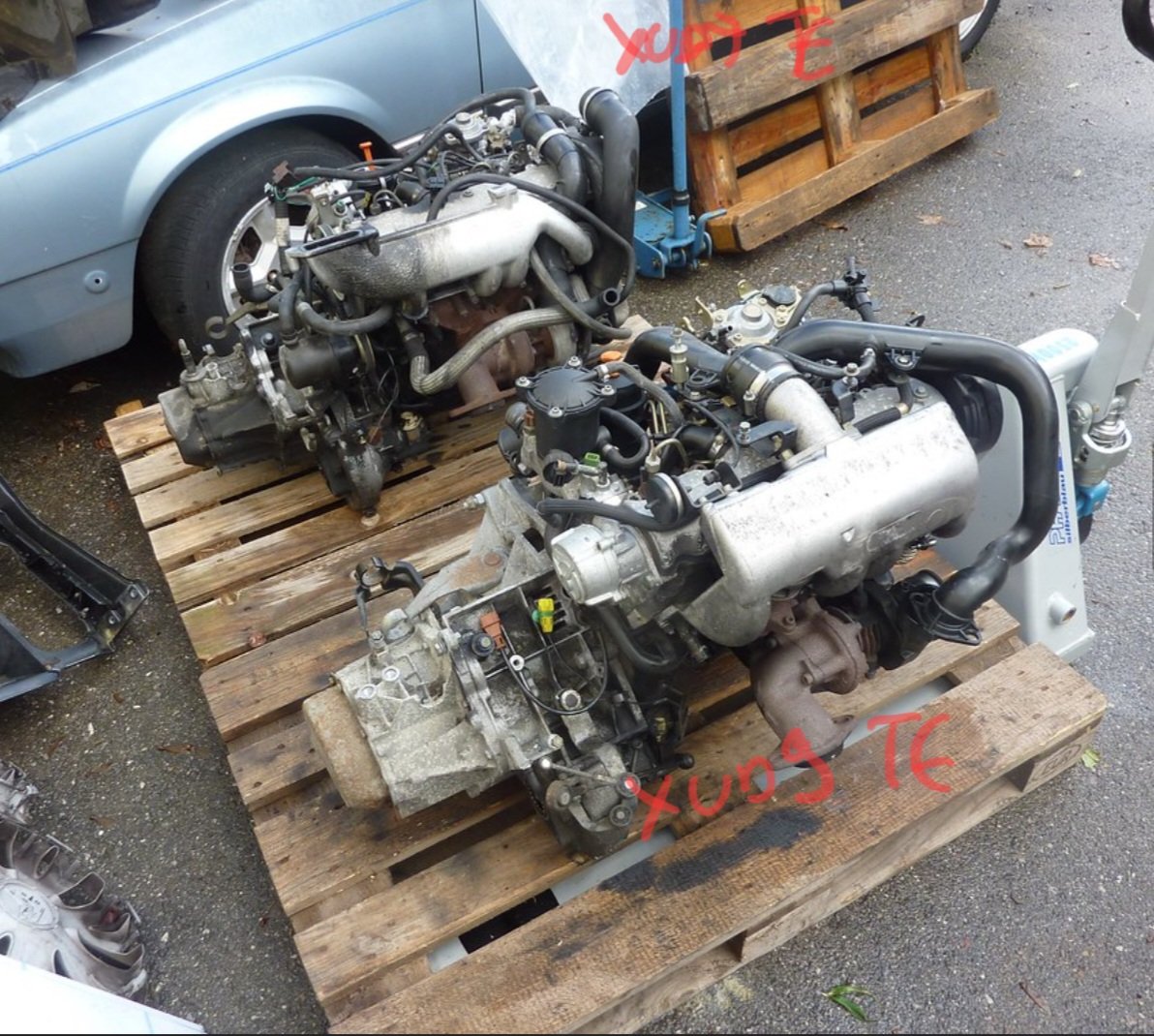

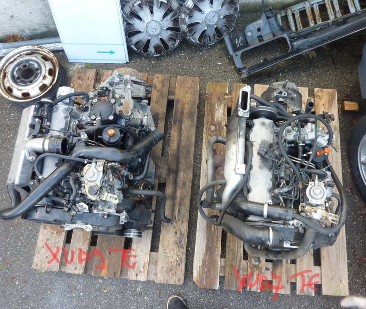

Hi all,
I have tzd bx with xud7te engine, cambelt skipped camshaft and cam caps broke off so i need new head, i have a cheap engine oportunity but its a xud9 te, i has a different intake on it and injection pump has some wires on it i think its for timing advance and there is vacuum pump on camshaft end instead of hydraulic pump pulley. Engine doesnt come with injection pump!
What i was thinking is heads look the same so i can swap my intake manifold, i can remove vacuum pump and install hydraulic pulley? And last most importat is can i swap my bosch injection pump and injectors from xud7te to xud9te??
Xud7 te to xud9 te
