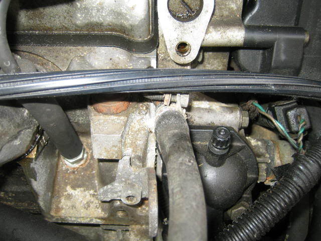

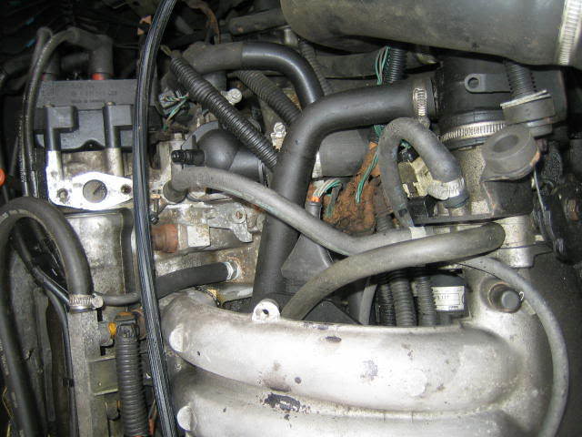

Whats this pipe called please
Its rotten & is on my Gti.
2nd picture is probably better one.
Its the one thats in the middle of the picture left of that black plastic half of a circle with a plastic screw on top.

Not sure exactly what it is, or does....but it looks to be part of the cooling system, and seems like it would be pretty simple to replace with a suitable length of similar diameter rubber hose. It doesn't appear to have any special preformed bends etc., so a nice, easy swap job with a couple of new jub clips should see it right! :D

Its the hot coolant feed hose for the throttle housing heater.
1351.56 - WTR OUTLET HOSE - 88.15DKK (ex vat) ~ £8 (ex vat) at your local Citroen dealer.

Just looking at the photos can't believe my luck. Basically my Tzi19 is a pig to bleed the coolant system as it doesn't have the bleed screw next to the thermostat housing found on Tris and others I guess. The other day at the NSW french car day I came across a tzi19 with the same/similar black plastic thermo housing with bleed screw as shown the above photos. Tracked down the owner just today to ask (thanks Craig and Paul) whether it was a later tzi fitment or a modification but he was unable to cast any light on the subject.
Does anyone know whether the thermo housing shown which obviously to me, an uneducated Cit person is on a different head configuration to a tzi19s would fit my head and can I get one, anywhere, or is there another version of it to fit a mine? My favourite part supplier here in sydney could only offer a zantia one which doesn't quite fit. Any ideas? (and thanks Mulley)

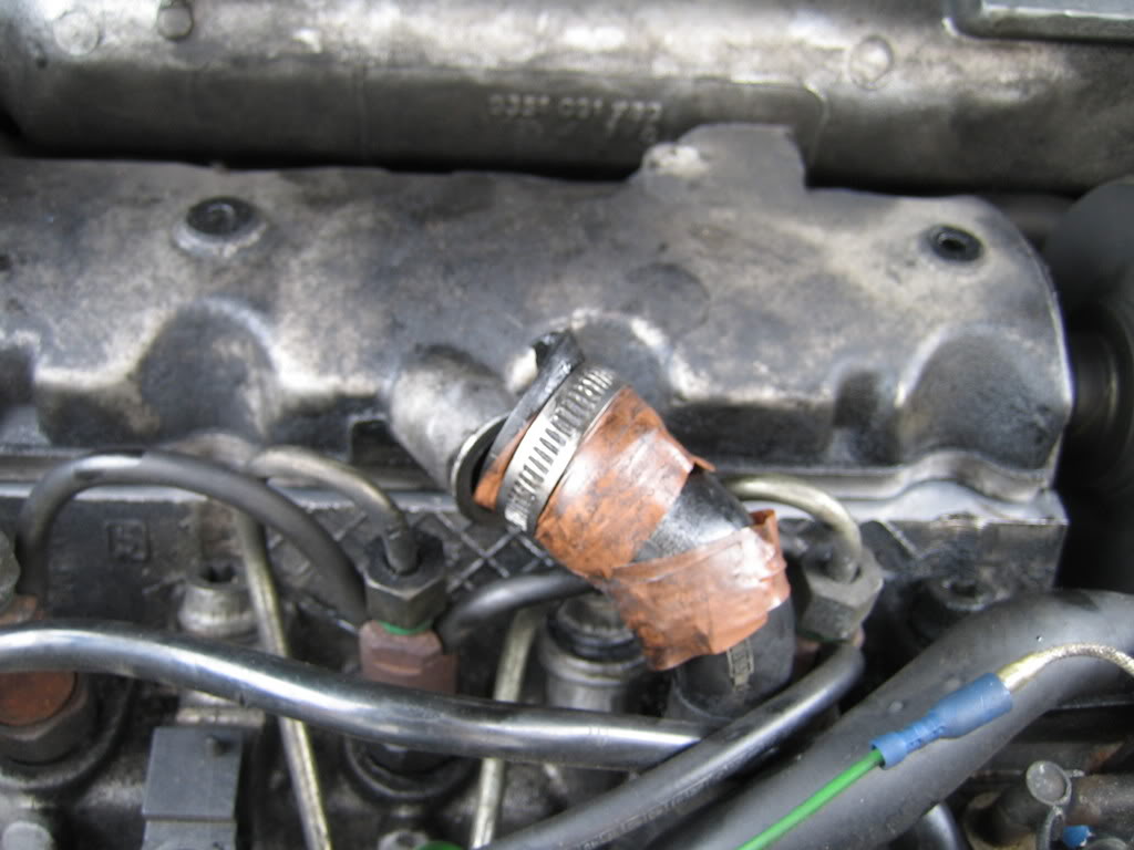

Right, i'm on a roll now with these pesky pipes, this one is out of the tzd, its the one which fits to the rocker cover & has tape wrapped round.
Is it a leak off pipe??
AndersDK
Posts: 537
Location: Denmark West
Post by AndersDK »
No - thats one of the common oil fume breather hoses.
Indeed, and they always split! Part of the design to be crap I think!
They are readily available and very cheap from the main stealer.
DLM
Our Trim Guru
Posts: 1624
x 13
Post by DLM »
I bought a new one yesterday from Yeomans in Fareham (off the shelf) to replace one that had broken in the same place. Under £10 including VAT.
Cheers for identifying this one also chaps, just need a replacement head & she'll then be back on the road.....
Just fitted the WTR pipe to the Gti, had to clean up the clamps a bit & ran the car, no leaks, so job done.
