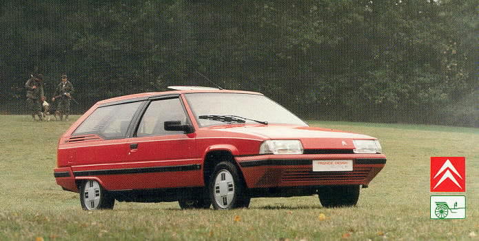

this could be a starting point

M
Post by M »
classic2cv wrote:were any made in RHD, come to think of it are there any in the UK, if so can i have one ? :D
Purely a concept car, converted from a base estate - so if you have an estate, a welder, some glass and a lot of time (and some Daves Isopon).....
