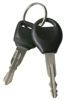

I don't know what the difference between a "flat" and a "bladed" key is. My English skills fail me
Though the general shape comes close to this:
On the key it also says "Simplex"... It's the only key I have, the other one got lost by the previous owner.
When I turn the switch, I can indeed her a clicking sound. Also, all the lights on the dash go off except for two in the middle. I will check everything you suggested on sunday...
