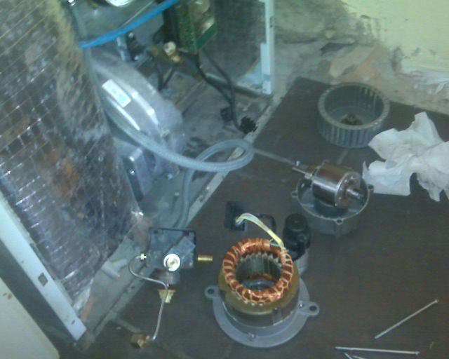

And in other news, the boiler refused to fire on Saturday, the blower motor had been sounding a little rough for a while so that was the first suspect. I was pleasantly surprised to find that the motor was dead simple to strip down and all that was required was one £2 bearing. Although I will replace both for piece of mind now it's in bits.
