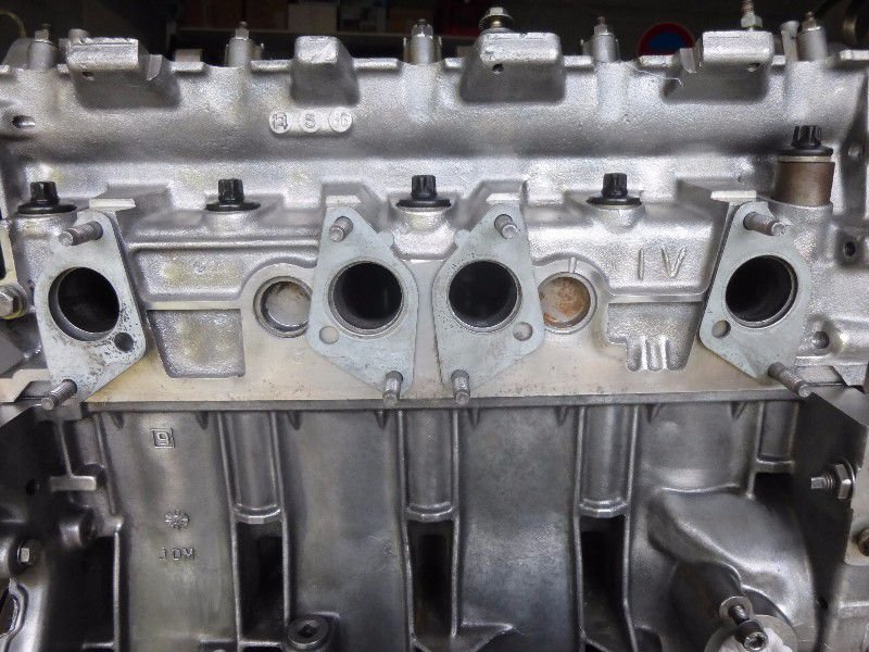

Finally a doubt: I noticed that a screw of the cylinder head remains "high" and does not go into contact with the cylinder head: checking on the internet I noticed that it needs a spacer..coincidentally it was missing :S
Can anyone give me the dimensions of this spacer, so that I can have it made in the workshop?
Cylinder head 19
Cylinder head 19
spacer on cylinder head
