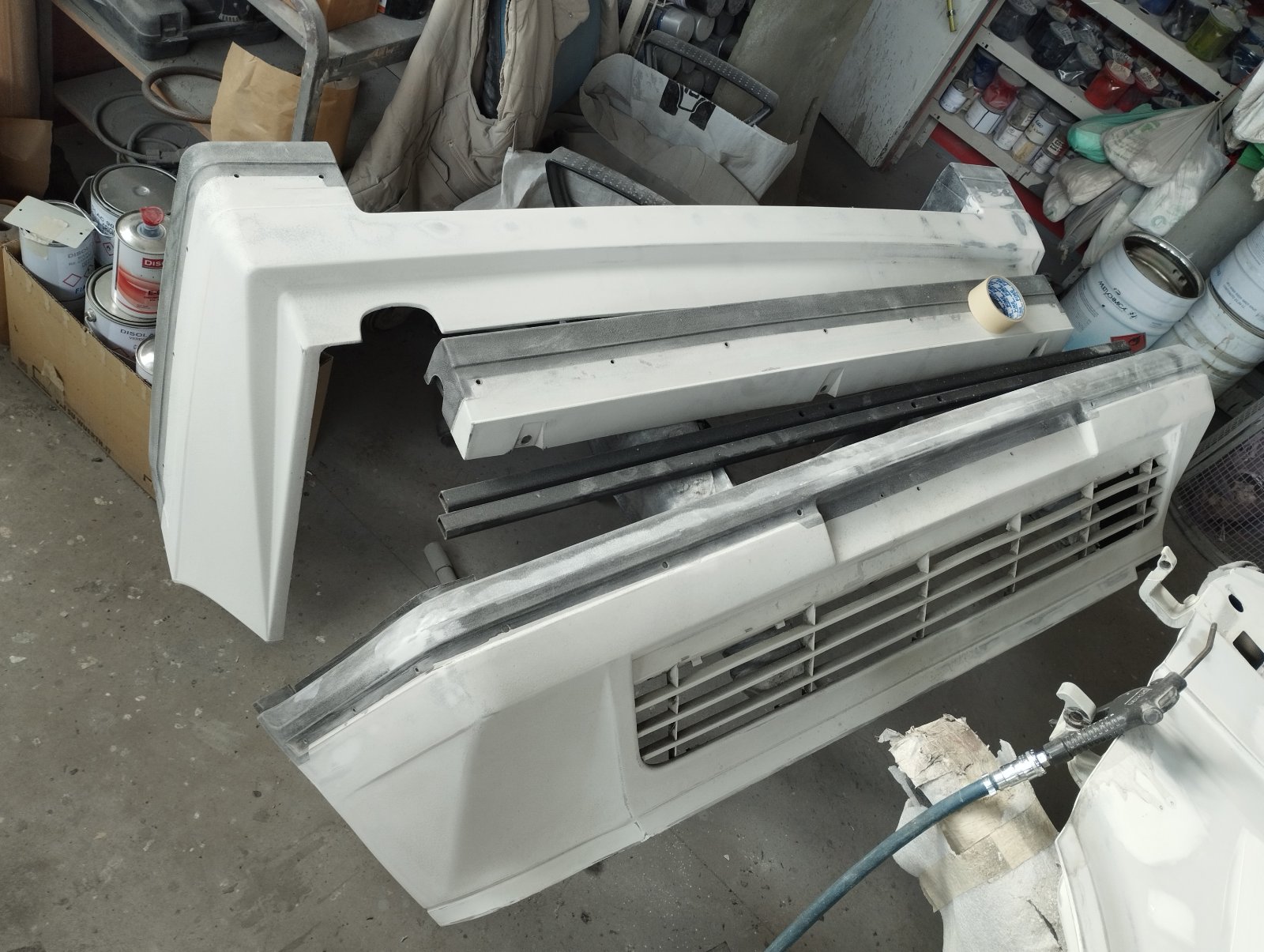

Here some photos of bumpers and tailgate restauration

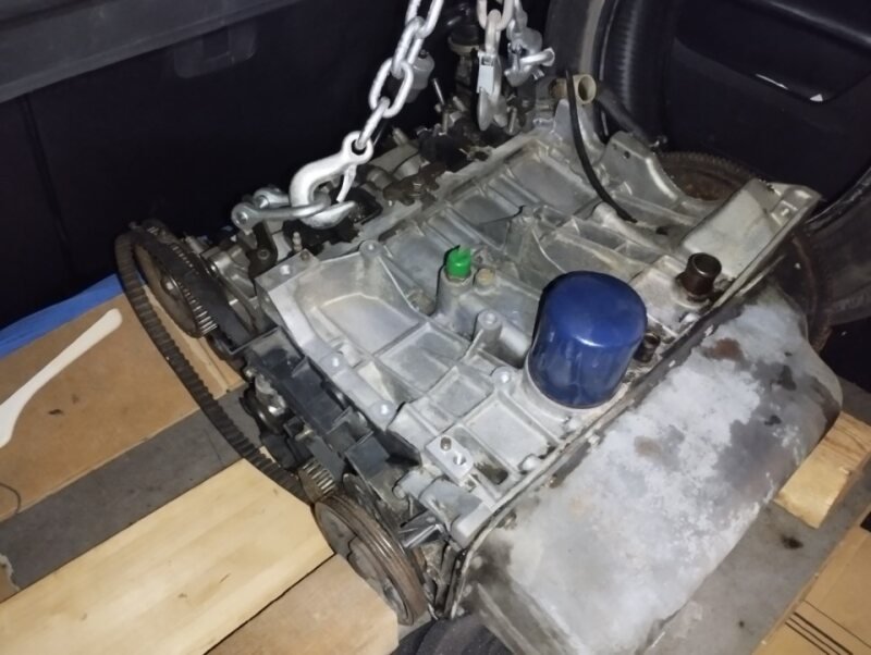

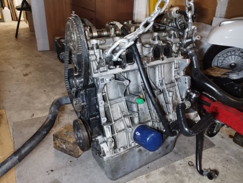

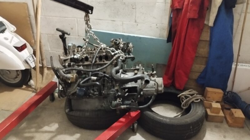

Hello ! Forgive me for disappearing from the forum, but I had some health problems (including a hernia) that stopped me. But here I am again.. since the beginning of August I have started work on the BX, finally dismantling the engine!
A difficult job to removing the axle shafts, it made me waste a lot of time, but then with a long lever, I solved it. Subsequently, after a good job, I finally managed to remove the engine! a great satisfaction. I immediately noticed some problems, fortunately minor:
- broken pressure plate lever
- broken flywheel rpm sensor support

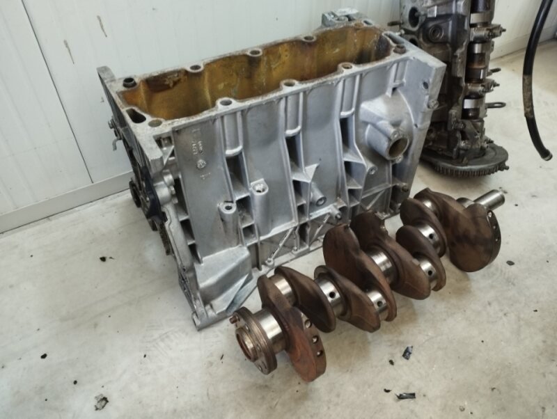

Now I have taken the engine to the workshop, and they have started to dismantle it, it seems in good health, I will fit new Tarabusi rods and pistons.

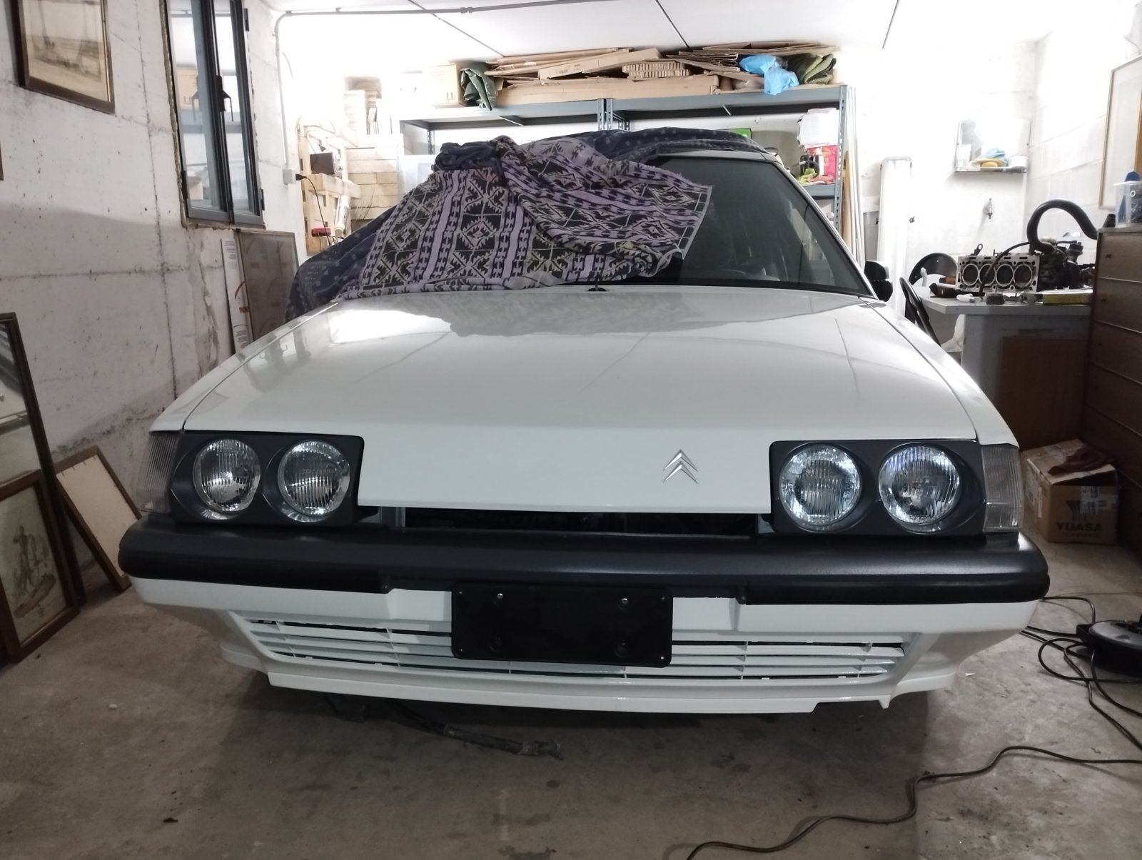

In the meantime I couldn't resist trying to mount the front lights
I'll have to fix the frame a bit because it was in an accident on the left side, but it can be fixed (the bumper doesn't fit well in the guides).

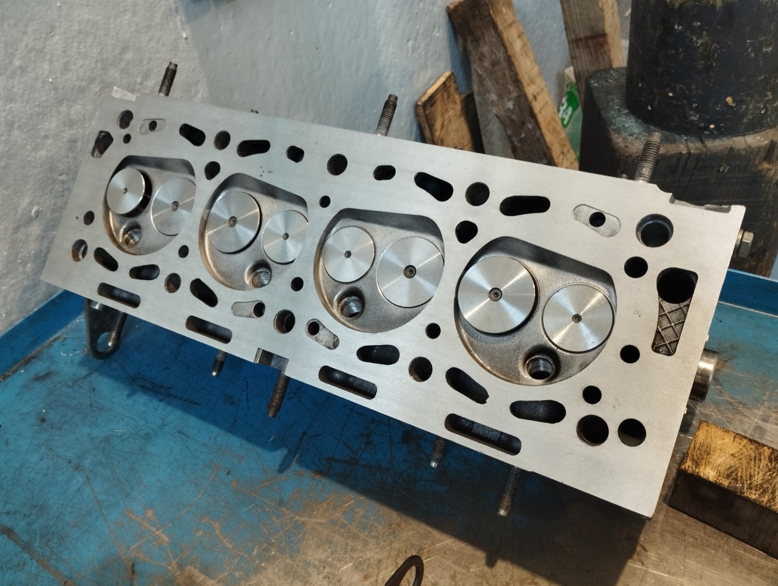

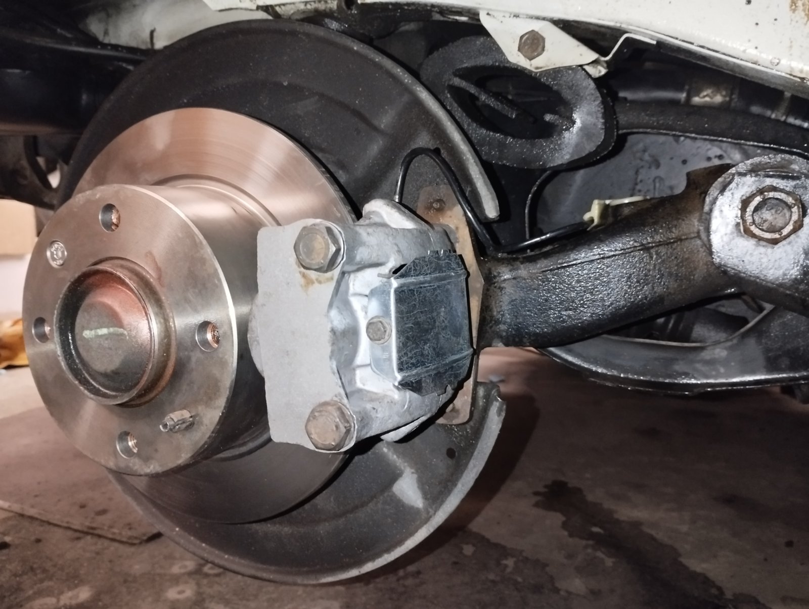

Hello everyone !
Just an update about the renovation works :

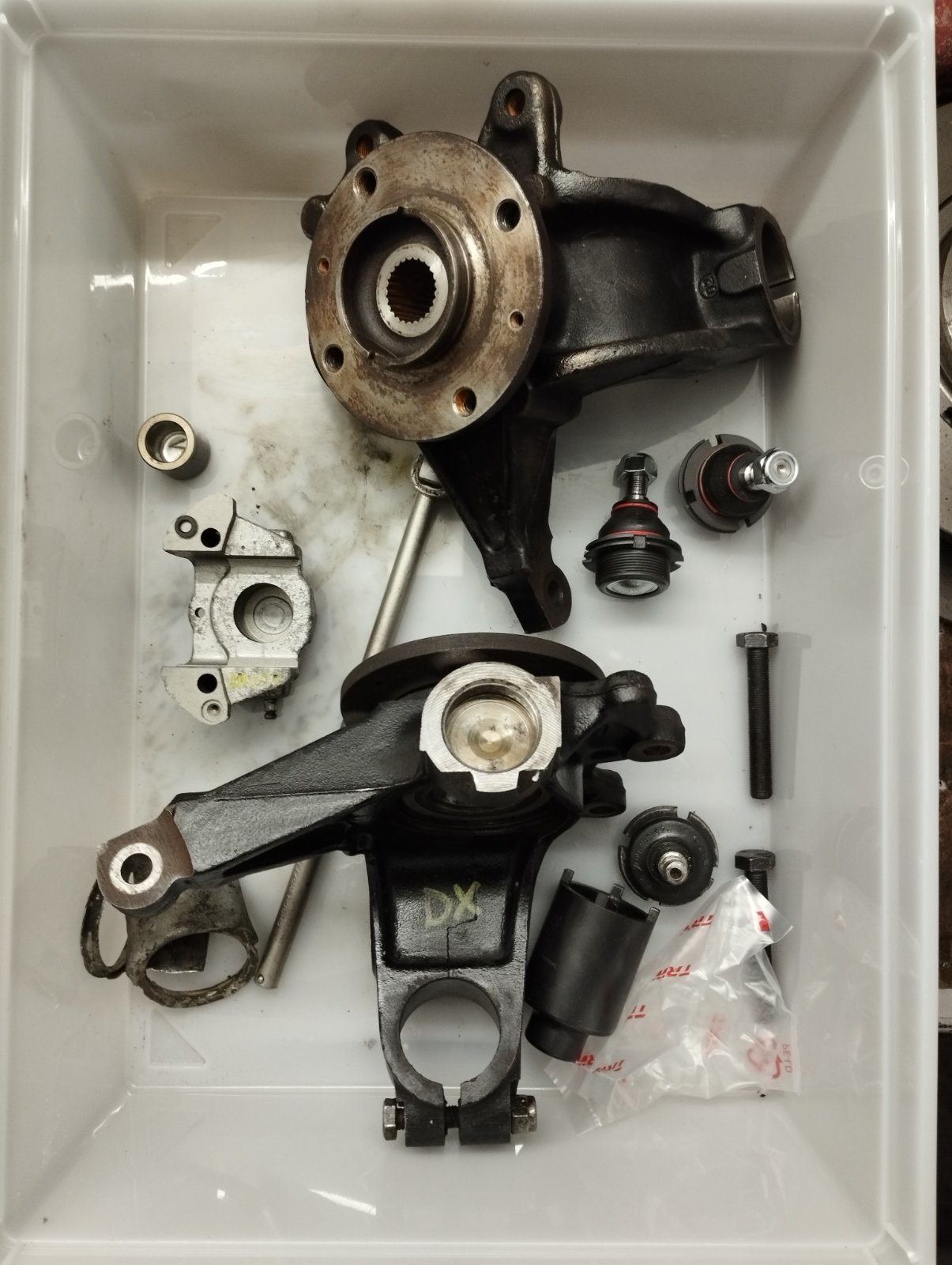

I've finish to renovate the whole front side, with brake disc, brake pad, brake pipes and steering head. Also on the back of the car, new brake disc and pad.
In the meantime, i cleaned the underbody. Now, finally, the BX is on its wheels!
At the same time, the head has been completed and ready to fit on the engine

Here the alloy wheels fit on the BX, it's looks good, but i need to modify just a little the rear fender, because the tires touch the fender..but just only on the "rest position".
panky
- Posts: 688
- Location: Widnes
'88 BX GTi (a long time ago) - x 174
Re: BX Break TZS renovation
Wow you have been busy. Great job.
- Posts: 2032
- x 116
Are the bearings of the rear suspension arms ok. When worn the wheels splay outwards / \ and can then rub on the bodywork.Rickyalbe wrote: Tue Jan 14, 2025 10:21 am Here the alloy wheels fit on the BX, it's looks good, but i need to modify just a little the rear fender, because the tires touch the fender..but just only on the "rest position".
We all love BX porn pictures
Thanks for the warning, one of them might actually be damaged, since it touches a bit..
