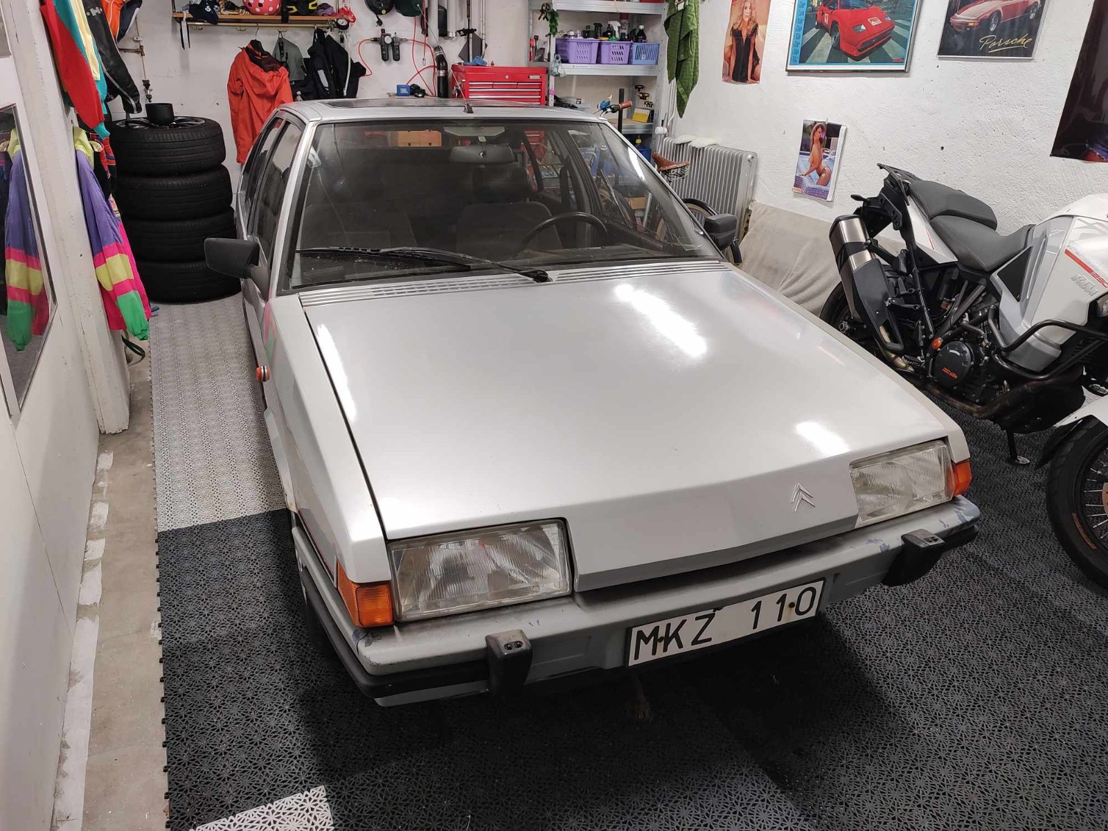

Interesting, I think my bumpers are in some dark colour benath the light grey spray paint. If I'm lucky, perhaps that's the original!? :)

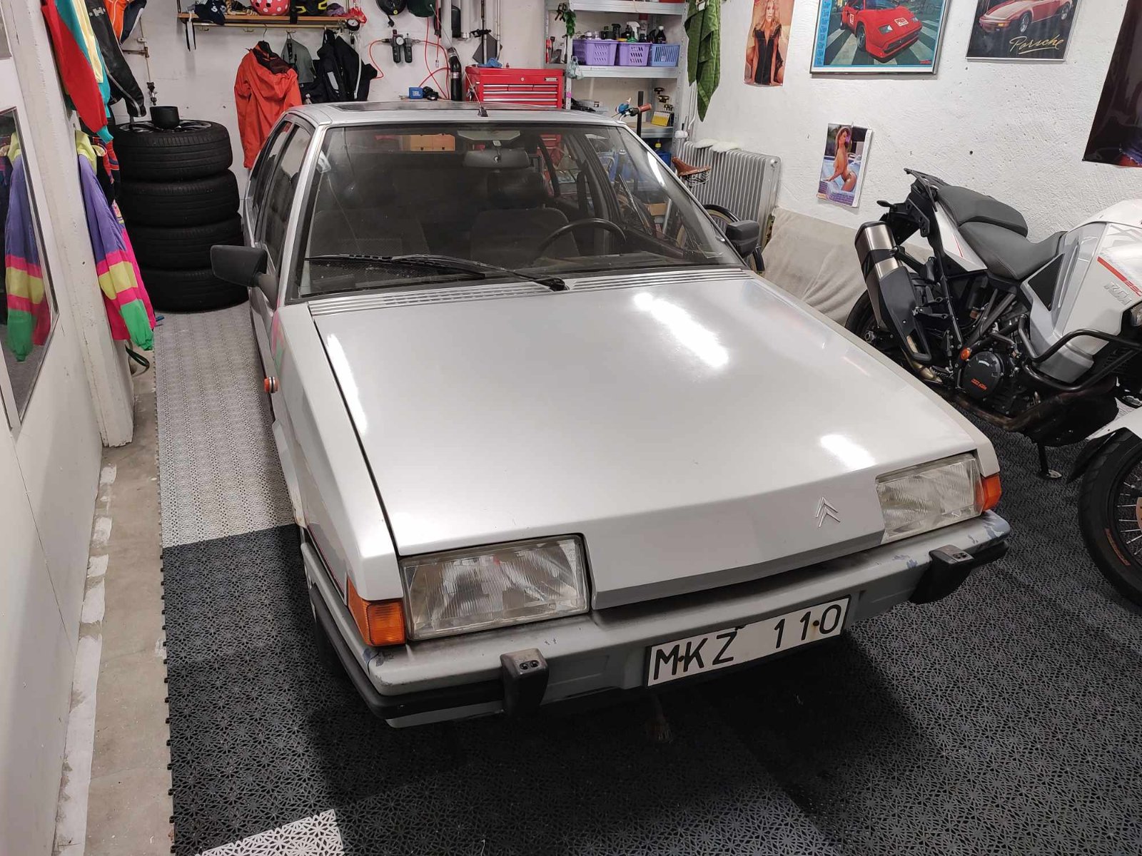

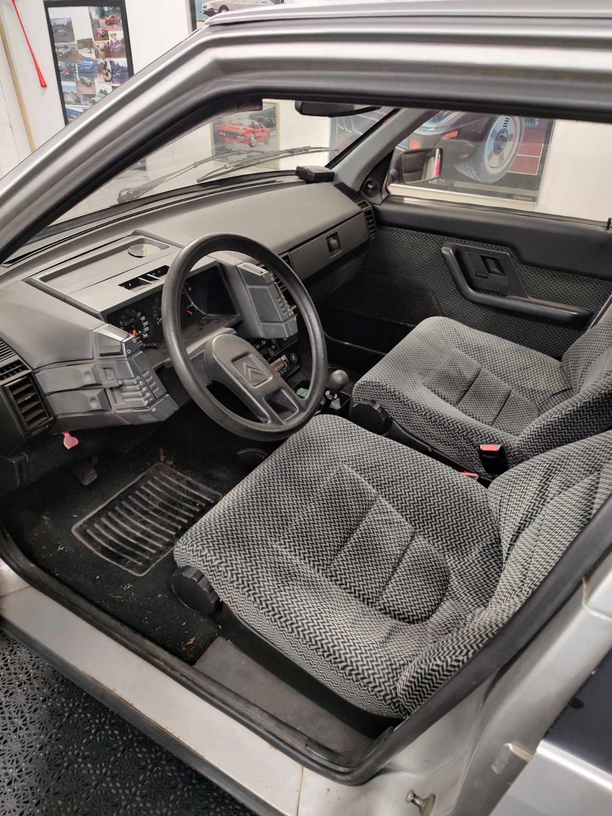

I think my car is EVE, gris perle met. It's silver in my opinion :)
Also found out (and remembered)that the GT's supposed to have an "onboard computer". Just as easy to find as hens teeth, I suppose. :D

OOOO nice car 8) I think the computer was only standard on the very early GT's, the ones with the tweed upholstery, and was an option on the later cars. It would be a nice to have though.

But there is a lot to do. It leaks, runs poorly and in need of an new right fender and two doors for example.

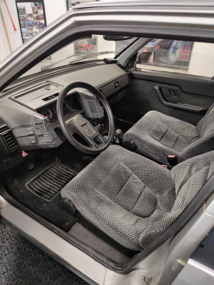

Ok, no computer . :) Just a clock that's been in front of the gear lever i guess?

Spot on, the 85 GT's had the tweed interior, light grey dashboard/plastics and fuel/trip computer but didn't have the wing mounted indicator or pinstripes on the sides.
