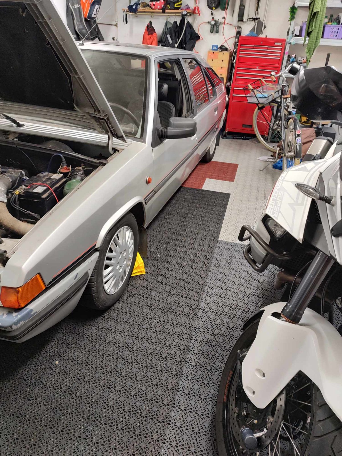

Hello all BX-drivers.
Recently bought myself a BX GT. Liked it since I borrowed one from the Citroen dealer in the early 90´s after driving my BX 16 RS into some logs (nope, it didn´t survive).
Anyway, in the 80´s, Sweden, along with Switzerland, had their own regulations for controlling emissions on cars. In one of the Haynes workshop manuals it´s described as regulations created by bureaucrats with no knowledge at all.
Anyway, the system usually fails, and I´m thinking of removing it. But I´ve been told the carb on Swedish cars are not the same as on "normal" spec cars.
So my question is: what is the GT´s original carb
No, my car doesn´t run as it should. I guess I have a vacuum leak somewhere. The EGR is broken and disconnected (and plugged in both ends) and I replaced almost 4 meters of 4mm. vacuum hose - and it runs better, but still stalls when letting go of the throttle (unless i use the choke), and it doesn´t like full throttle on +4000rpm
My "girlfriend" (OT: what do you call someone you live with, but are not married to in english? In Sweden we call it "sambo", short for "sammanboende", translated it would be "living together - so why not call it "lito" in english)
said just black smoke came ut when I floored it.
BX 19 GT -86 Swedish spec on carb?

Hi Jesper, what an interesting situation! I am in the UK and have a 1985 19GT and a Swiss spec 1986 16TRS SE automatic.
The TRS I bought as an air conditioning donor vehicle for my GT, it too has the emissions control system - a very complex system with vacuum lines everywhere and EGR. I have tried blanking my EGR system on the TRS but it runs worse! The original carb will need rejetting I think to avoid lean/rich conditions with the different airflow after EGR removal. if you keep that original carb. Or just get yourself a decent UK spec carburettor and have done with it all!
My TRS has a Weber 32/24 DRTM and at least used to have 75bhp, but UK spec 16's had a 32/34 Weber DRTC or Solex 32/34 Z1 with 92bhp. I am currently looking for a UK spec Weber DRTC for my TRS as it also does not run properly, I plan to remove/blank off all the emissions control systems as it is overly complicated I think. I was going to use the TRS for a parts car, but it is too rare and too good a car so I will get it registered, MOT'd and find a nice home for it. She deserves life!

First if all: Tom, thank you for your detailed answer.
As you wrote, it's easier to find a "non-swedish" carb than trying to get the vacuum system work. I've read about people who has done it. And the car runs much better and the emissions are better as well.

Interesting, I think my bumpers are in some dark colour benath the light grey spray paint. If I'm lucky, perhaps that's the original!?
Perhaps it's easier to try to fix the emission system rather than finding a carb!?
My car is an drivable object with lots to do (and parts to find). But I like having something to tinker with instead of watching TV.
