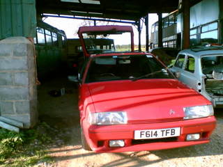

Kitch, If your red beast finds its way to a building near Stroud anything is possible by xmas. Although I'm not saying which xmas!!
In terms of my red beast, the plan at the mo is this:
The rebuilt head is on (triple angle valves, ported, opened out the exhaust manifold) and it's still gona run the Garrett T2 and standard Lucas pump for now just to get it mobile again..
Haven't finished it yet or run it up but if it works I'll plod on with it as is untill next summer and then:
Have a cast iron head made for it (should eliminate gasket issues)
Fit the seriousley modded Bosch pump (5200RPM red line, Twin throttles)
Fit Garrett T3 water cooled turbo (with its own coolant tank, rad and pump)
Fit Full size intercooler
Keep the high lift cam.
I'll aim for 140BHP and see how it goes.......

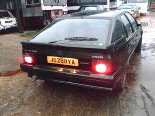

In terms of the current project, it's reached that stage where although I got alot done today it dont seem like it since I'm now into fiddly bits that take forever!

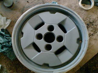

The wheel from El Presidente is now undercoated, I'll top coat it and lacquer it over the weekend, then have a new tyre hoofed on
Most of the interior trim is now in and I have only the pin strip and N/S/R 1/4 wing trim to fit

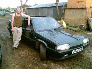

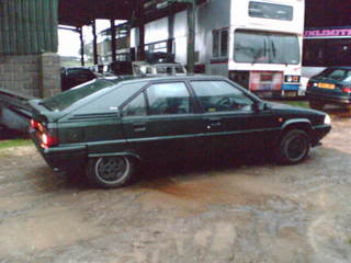

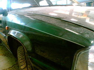

Although I went slightly overboard with the panel bonding so will need to clean it up to look spot on:
So hopefully if I can get a full weekend on it then I might just have it looking brill. That leaves a trip to Kitch's to collect a proper Green tint light unit (Bless him!), a bit of welding on the front inner wings and stuffing some new mains, big ends and an oil pump in her complete with 16v sump so all the gauges can work!!!
Ok, I'm biased but I think it's looking good!
Expect another thrilling instalment on saturday. I know, I know, you can hardly wait... :D :D :D

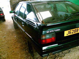

Well, this weekend has seen plenty of effort but because it's all really fiddly and wiring related it seems like little has occured!
Amazingly, everything seems to work so my wiring skills must be improving!
Although the stereo is dead.... So I've bu**ered something up somewhere!

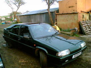

The front seats are now in with the door cards, spent most of today setting the bl**dy sunroof up but it now fits and tilts and slides so I'm happy!!

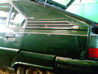

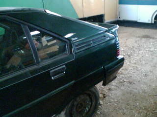

Got all the pin stripes on which tidies the car up alot:

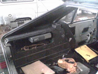

and mounted the autochanger properly in the boot which is more than did with either of mine, they're just slung in the boot!

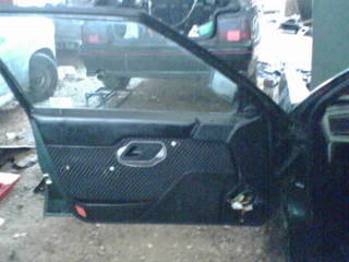

All the windows now go up and down:

:idea: Guess that it was easier to lay the autochanger interconnects with access to the regular cable paths?
The reference & photo about the gearstick also reminded me that Citroen never handed this item so the stick itself obscures the indication. (Got used to mine now so had vitually forgotten it until the photo reminder). :D

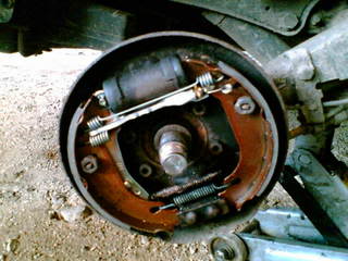

Ok kids, I lied, this weekend will not see the end of this post, got next to nothing achieved on the car today since I was getting dad's new runaround ready for MOT so hopefully next weekend will see the end of this thread but dont count on it!
The rear brakes were bu**ered on the new runaround, ZX TD thing, very bland! Bendix rear brakes, expensive and crap....

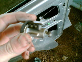

and the drivers door lock didn't work, was obvious why when the door card was off, the plastic arm on the back of the lock was broken
I pillaged one off my mates ZX volcane scrapper so it now all works!

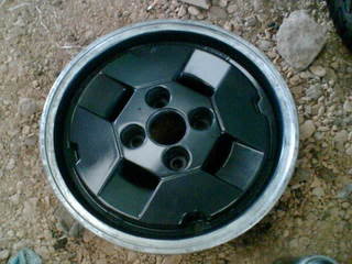

The wheel from El Presidente is now lacqured and back in Bristol so it'll have a tyre fitted monday
