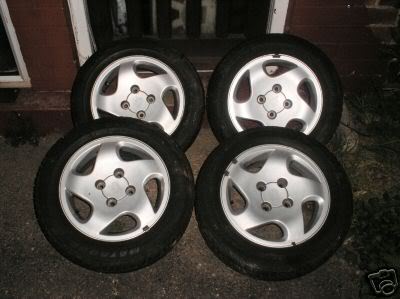

Well...I've had a bit of a break (I think!).
Just won these today on the 'Bay, for £36.
I emailed the seller a couple of days back to ask how much he was looking to get, and he replied "at least £100", so I just sat back and watched! Couldn't keep my finger off the button in the last few minutes, so I won 'em! :D
What do you guys think?
They are off a Pug 405.
cheers1
Dave
Posts: 6437
They're 306 alloys. They'll be 14's with quite wimpy tyres, and the offset is a little big, but not on the scale of the 405's at least.
Personally I think they look too modern for a BX. I liked the 1.6 GTi alloys, and you can get them balanced at most tyre centres off the car, they just need the adapters for the machine. Its best to keep them, as Saxo VTR's use an indentical system and we know how common they are. :lol:

Kitch wrote:They're 306 alloys.
That style of alloy wheel was also fitted to very late model 405 GTX's, so they could be off a 405.
That excuse from the seller is an utter load of crap. How can they have been sold on a car if they are pictured off the car? That's going to be a fairly hefty negative feedback if ever there was one!
You might be interested in these:
These are 306 alloys. Not sure what model 306 they are from (possibly s16), but they're currently fitted with 185/60 14's, which are incorrect for the 405, but correct for a BX. I can't make up my mind if I want to keep them on the 405 (with some correct tyres) or not. The tyres are in good condition, and all have about 4-5mm of tread left. (they're pirelli p6000's)
Interested? (anyone?)
