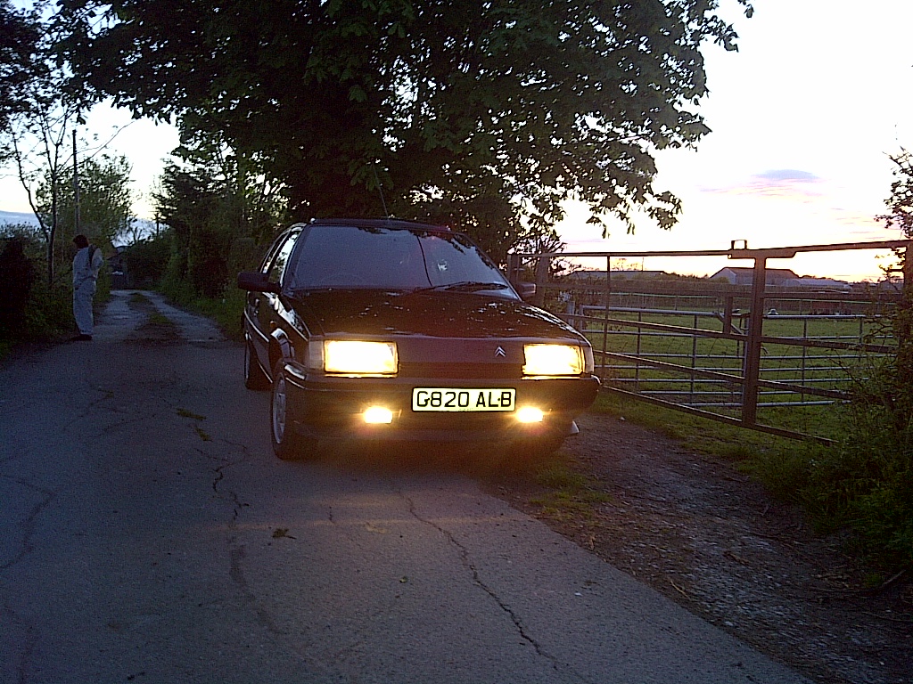

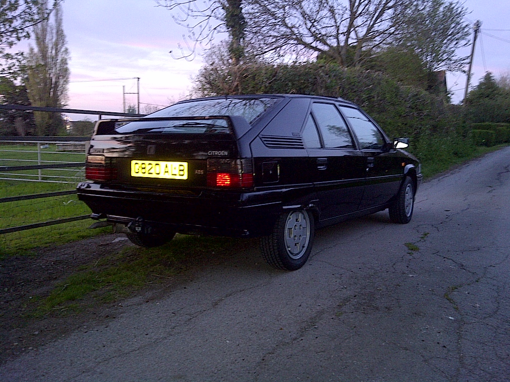

Heres some pictures of Albertine
1990 Black BX GTI

GTI looks stunning, they always do in shiny black. I think you've got rather a nice one there!
