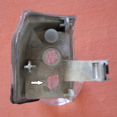

Have done a test fitting of a pair of LED units into one indicator unit on the bench, and fortunately the LEDs main throw is forward (they have a lens at the tip), and they sit inside the silvered masked portion at the side.
Still a bit of playing about to do.
Have seen a good few cars with aftermarket LED strips under headlights, and it would be a very straightforward fitting in that gap on the BX. However, I'm not keen on the drastic change in driving appearance it would give the car, so would rather make use of the existing small fittings.

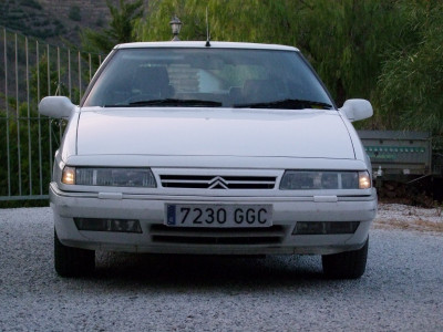

This is what I achieved for the XM a couple of years ago...

While by the letter of the law that wouldn't be legal here, and the UK has its own rules on vehicle lighting, that looks so 'Factory' i bet no one would even notice.
