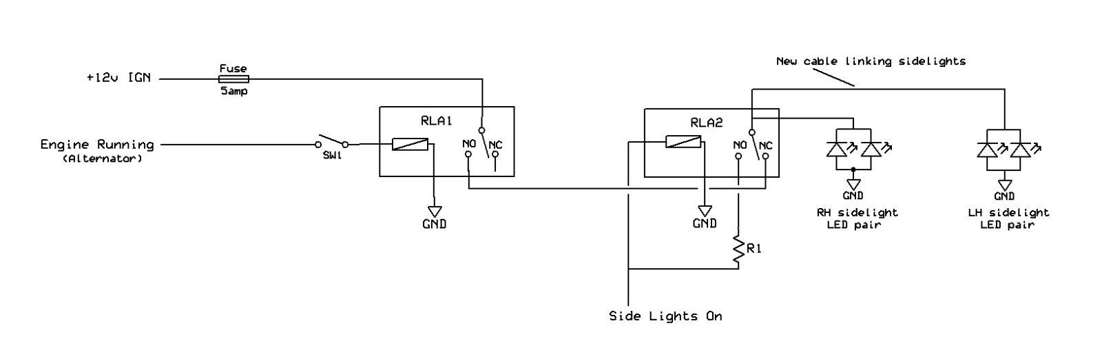

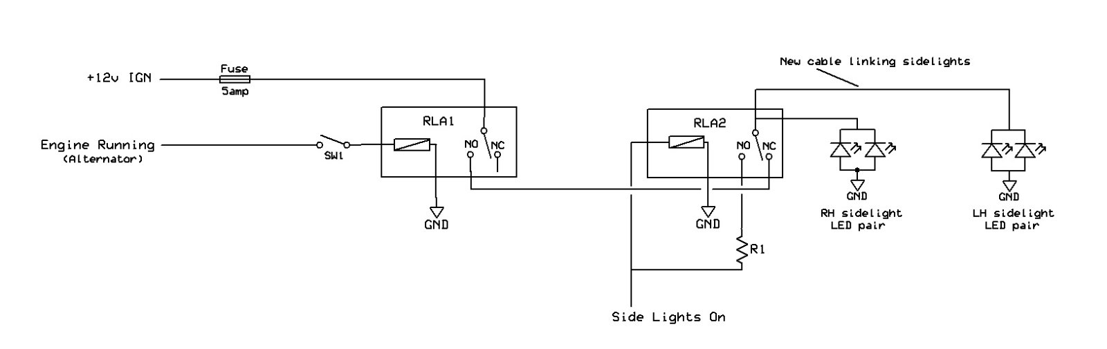

The fittings will likely get 2 x "50W" T10 warm white LEDs each, which will operate full-on in daylight, but drop back to side-light brightness when lights are turned on. While an indicator is flashing, the DRL in that fitting will extinguish. The O.E. parking lights in the headlights will be off for normal driving, but will work as parking lights and when the DRL system switches off. A small plastic box and a few relays will do the switching, with a few external connections.
Did a similar system for the XM a couple of years ago, with the same double T10's in its front sidelights. Simpler there, because no need to interrupt the DRLs for indicating, as they are in well-separated units, and the new LEDs (dimmed) also function as side/parking lights.

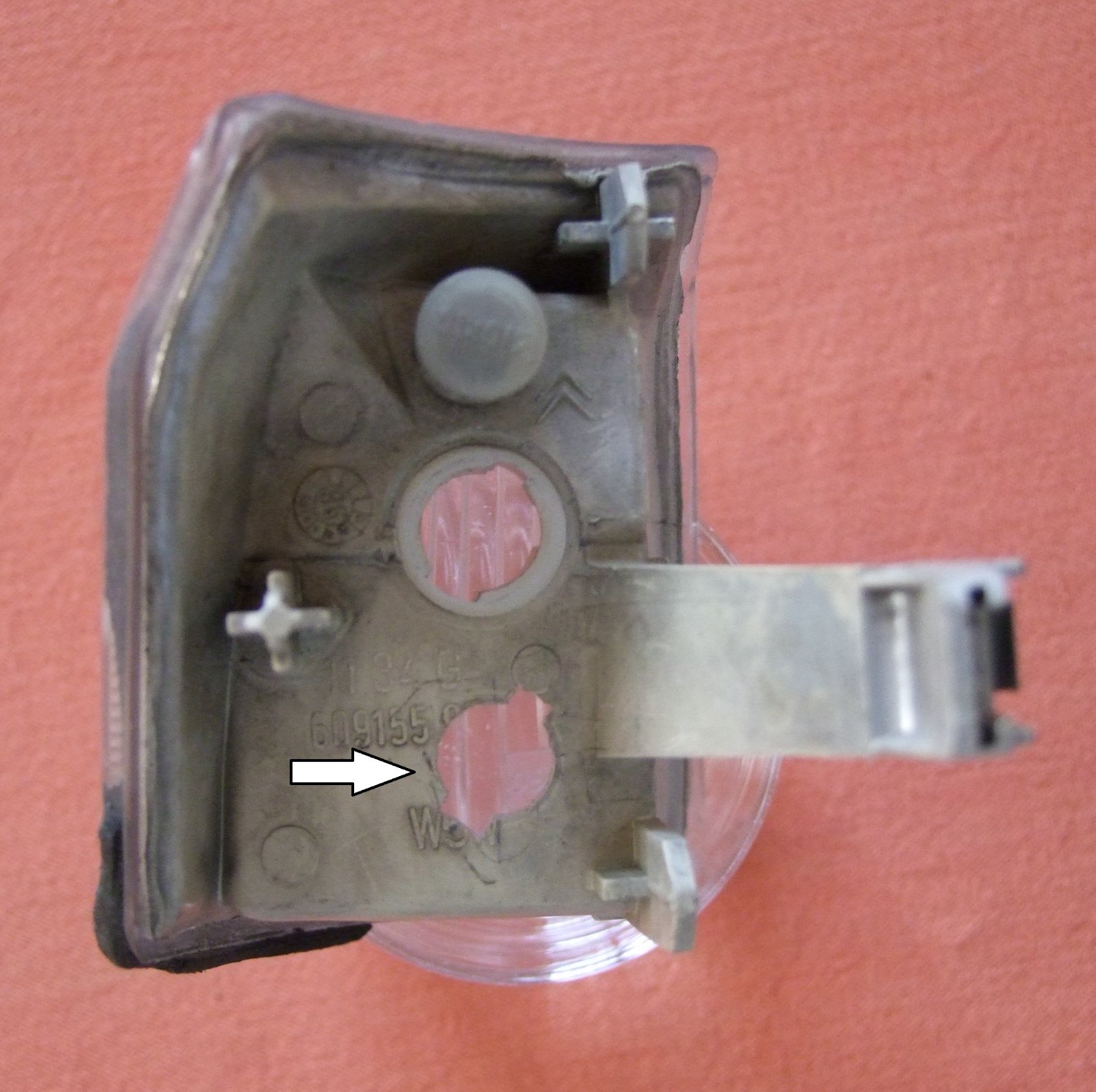

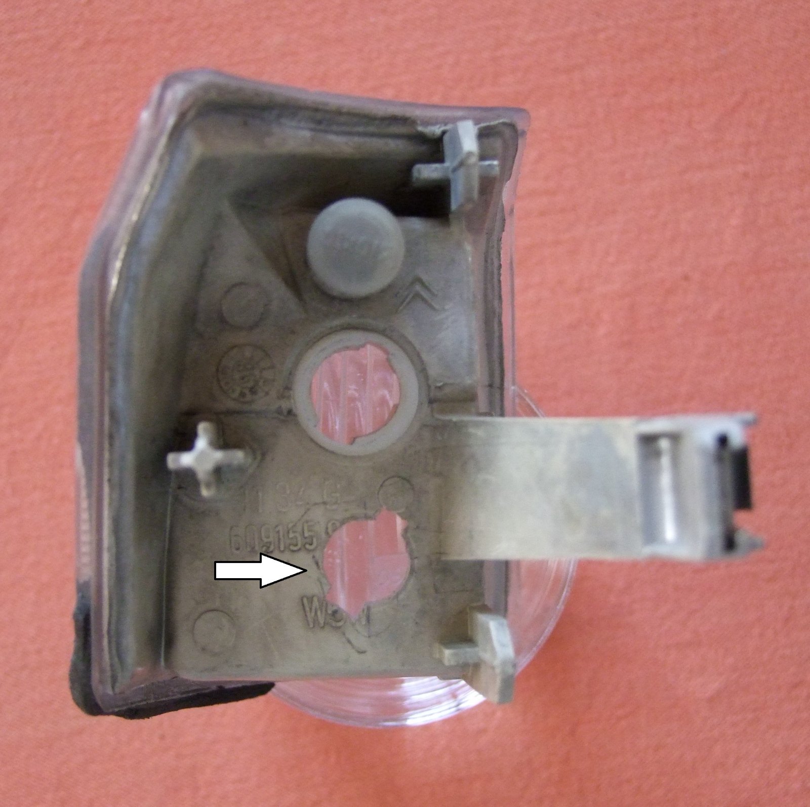

Have done a test fitting of a pair of LED units into one indicator unit on the bench, and fortunately the LEDs main throw is forward (they have a lens at the tip), and they sit inside the silvered masked portion at the side.
Still a bit of playing about to do.
Have seen a good few cars with aftermarket LED strips under headlights, and it would be a very straightforward fitting in that gap on the BX. However, I'm not keen on the drastic change in driving appearance it would give the car, so would rather make use of the existing small fittings.

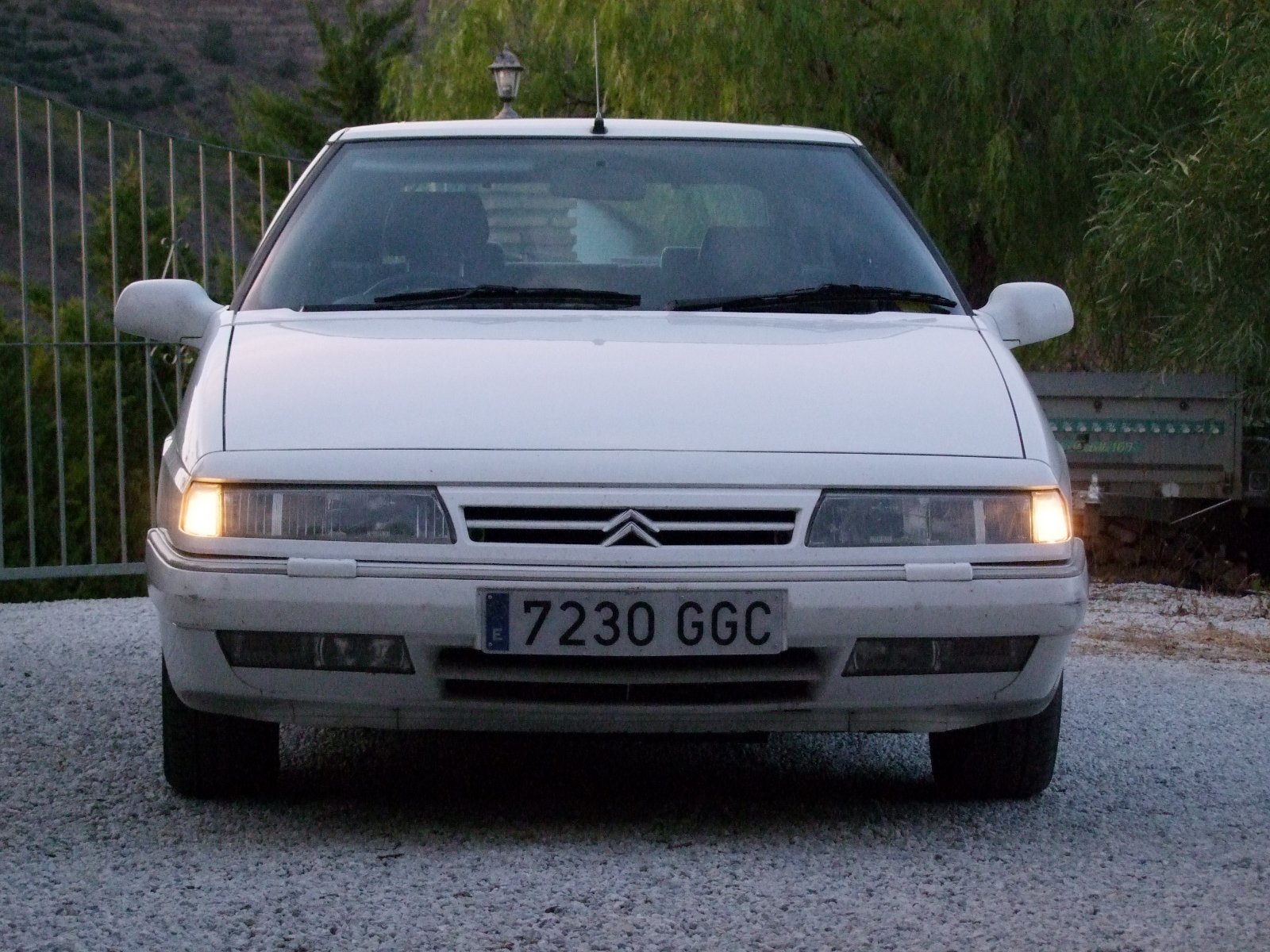

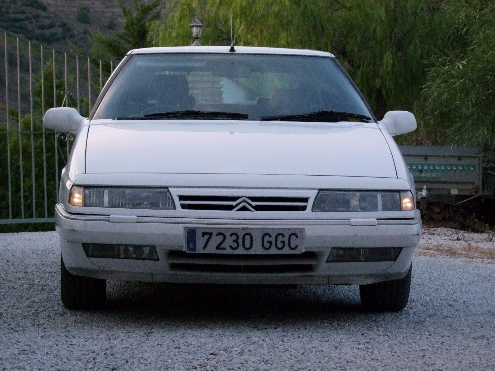

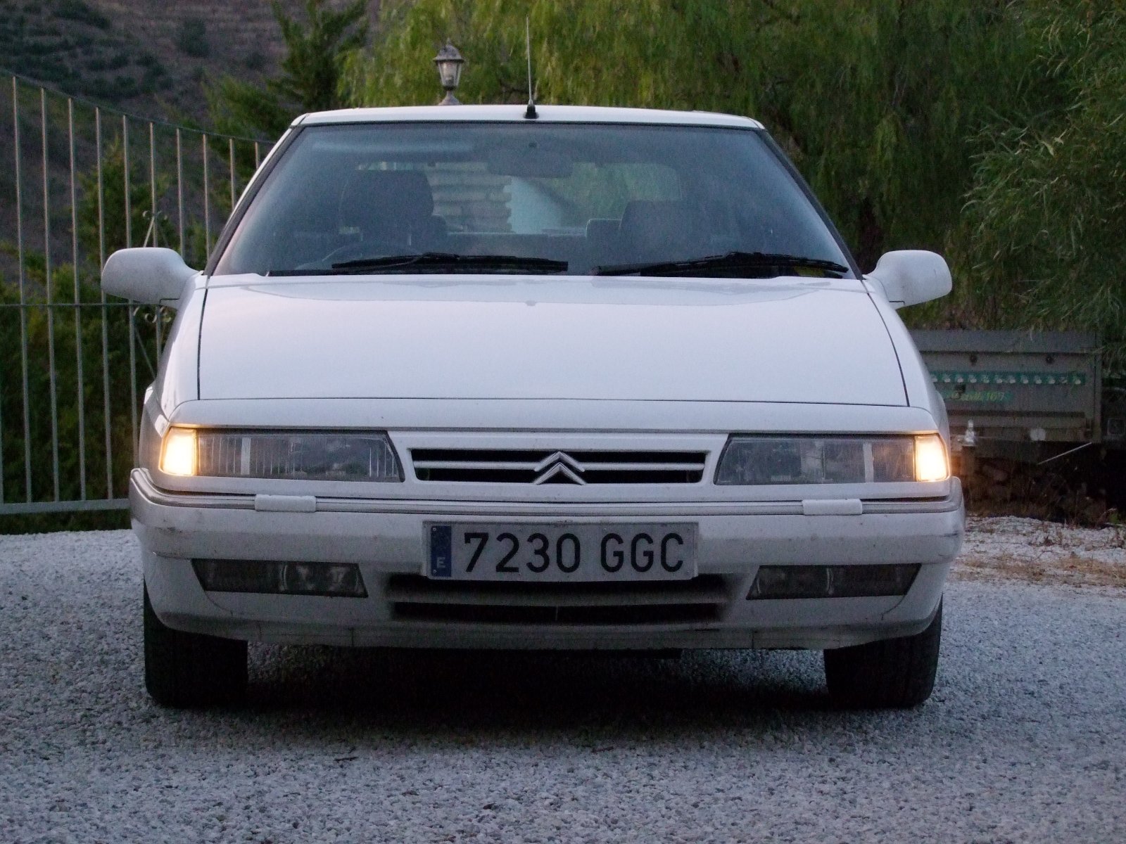

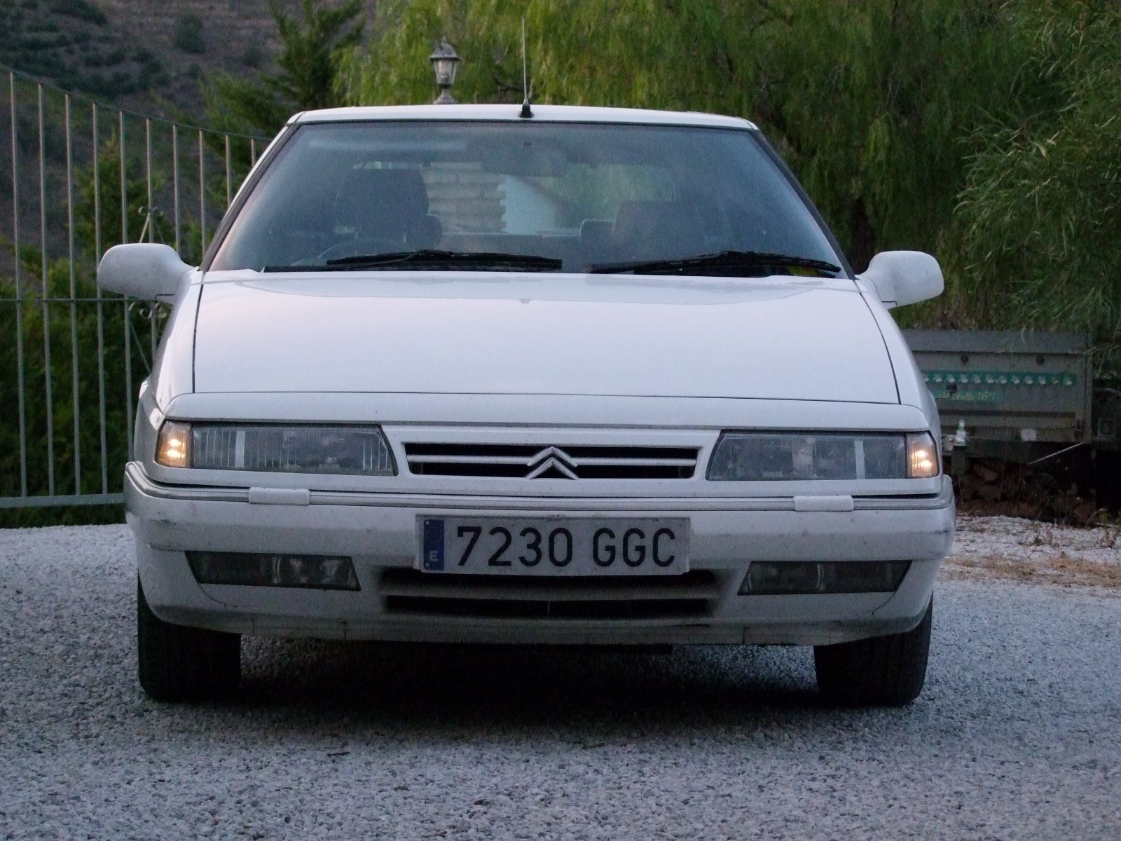

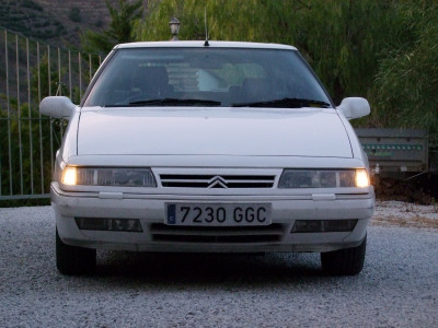

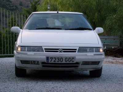

This is what I achieved for the XM a couple of years ago...

While by the letter of the law that wouldn't be legal here, and the UK has its own rules on vehicle lighting, that looks so 'Factory' i bet no one would even notice.
